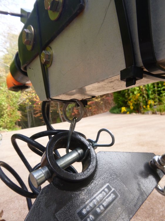

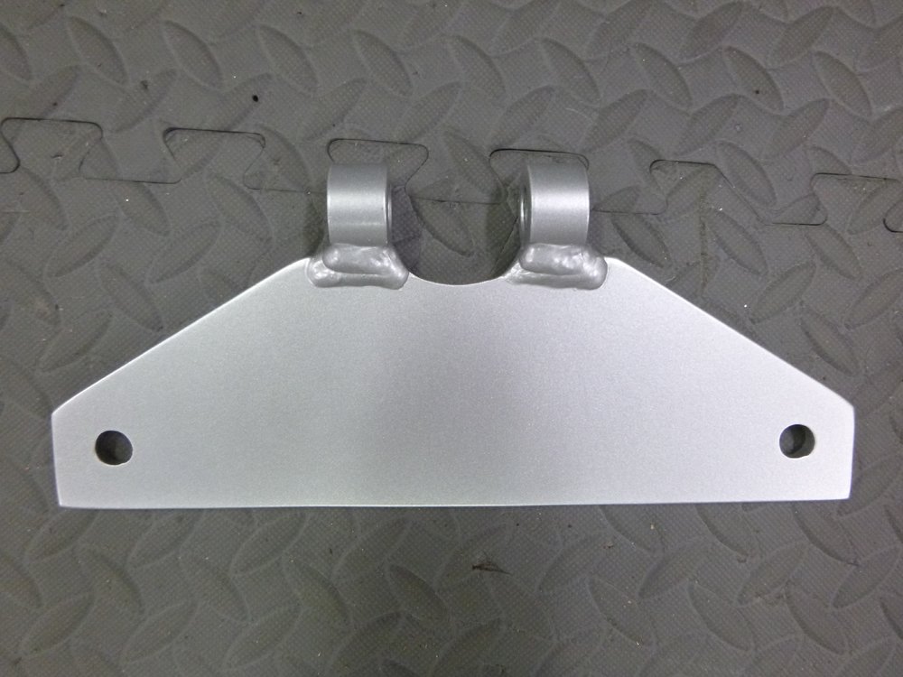

These are pictures of the "new" versus the "old" Andersen whaletails.
First the "old"
Now the "new"
Note that the "ball housing" is also a bit different from "old" to "new", but, the differences do not show up in a photo very well.
