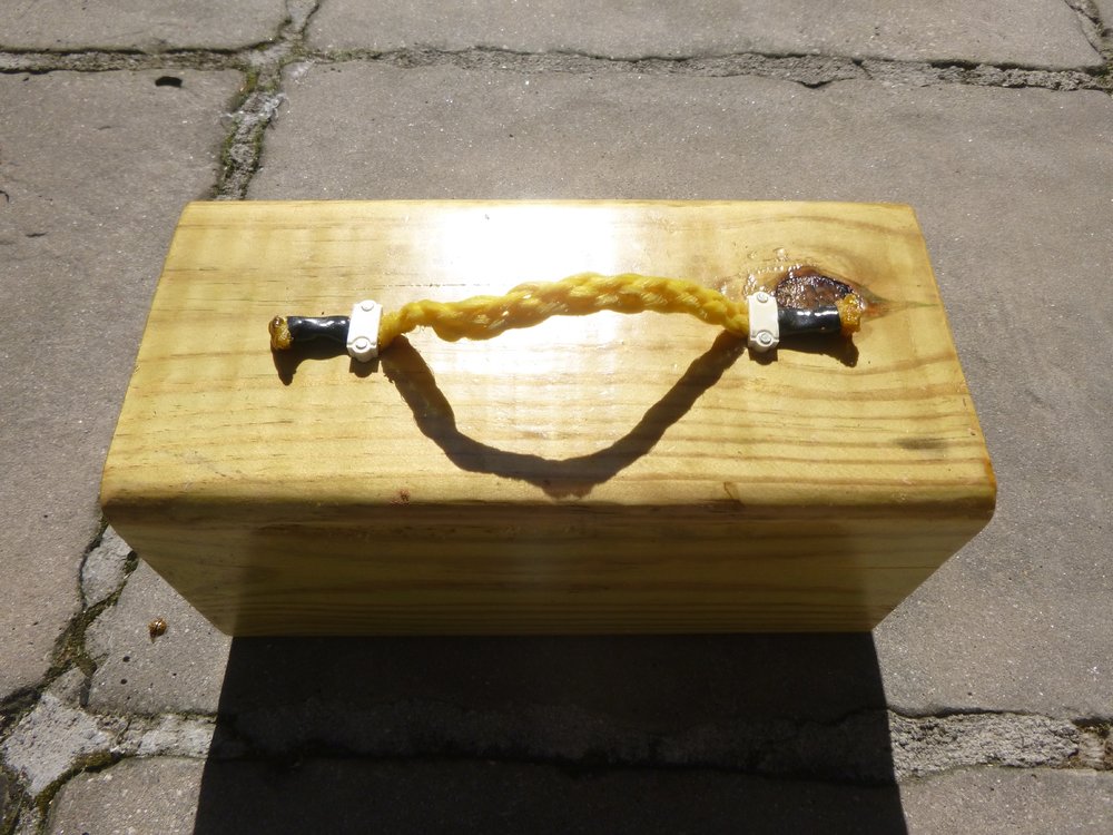

I also carry the "lego" type blocks that Spike mentions.  But, I've found that I tend to use the wood blocks in the picture below more often than the legos.  These do not have to be "stacked" since they are one piece.  If you cut these right at 11 inches tall, they will fit nicely under your rear jacks while on a level or stern (rear of the Ollie) elevated surface.  If the stern is lower than the front then I just lay the block on its side for what is about 5 1/2 inches of height.  And, if you keep your eyes open around construction sites, you can pick up scrap pieces of 6 x 6 lumber free.

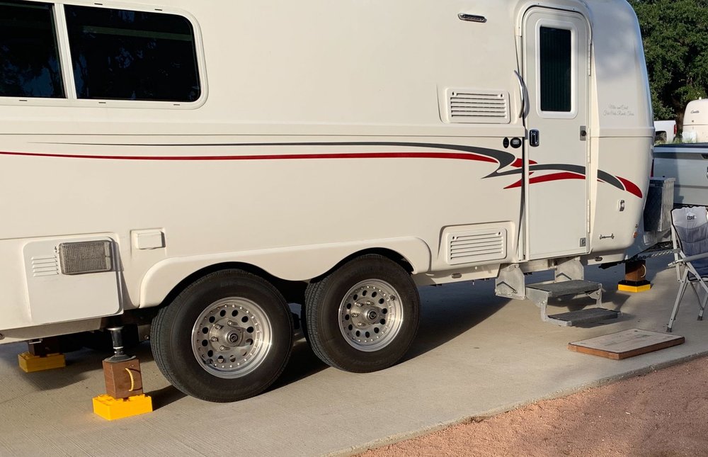

We’ve tried several methods. We started using scrap 2X6 pieces for leveling and under the jacks. Here’s what we’ve settled on:
We use the front jack to level front to back. The back jacks are for fine tuning left and right. We bought two sets of the yellow lego’s (12” square) at Walmart. There are 10 in each set. I also made some blocks out of 2X6 lumber, much like Bill pictured above. If we aren’t level left to right we use the legos under the tires to get near level. Then we stack legos under the back jacks so that the wood blocks are just an inch or so below the jack, same for the front jack. We usually don’t have to have more than a few inches of jack travel. It’s quick and easy. The plastic isn’t affected by water and keeps the wood up off the ground.

Hi Mike and Carol, First off, thanks for responding to my post!  After looking at the photo on your post, I was wondering if you use blocks on your tires? Or maybe not just in this case, on a concrete pad.  Is having the trailer supported just on the 3 jacks enough. Or do you need a block under the tire and even that tire locking device to stabilize. I guess I'm wondering if the rule is to level by using blocks under the 3 jacks, and block the tires and use thst tire lock device.  Or is that too extreme?  I'm thinking that when trailering less is more, keep the weight down and gear down.  But, don't know.  Want to be safe but don't want to pack a bunch of unnecessary gear. Thanks again for your help!

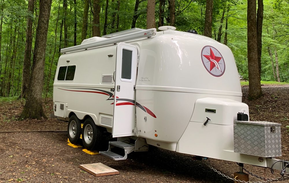

That’s a great question, I should have explained why my tires aren’t chocked - at this site we were just overnighting and I did not have to unhitch from the truck. You can see in the picture my Andersen chains are still tight.  Before I unhitch at a site we always chock the tires. Both sides. Also, if I have to drive up on legos, the standard wedge type chocks aren’t as effective so I have one of those “between the tires” or x-chock devices. Some are quite expensive. I got the inexpensive Camco plastic one that works fine. Another Walmart item. You can see them in this photo:
