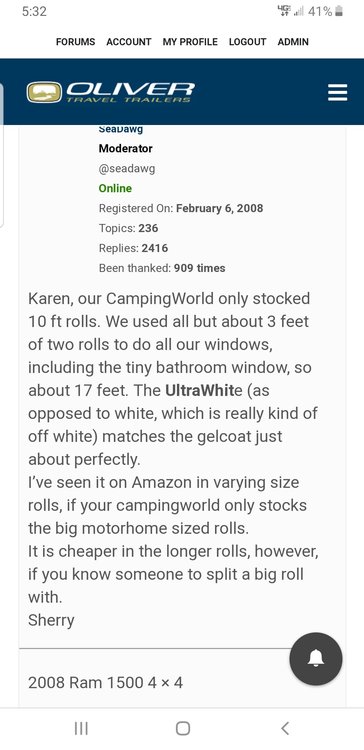

Moderators SeaDawg Posted August 12, 2019 Moderators Posted August 12, 2019 Greg, they have two different whites. We found the bright white to be a really nice look. Sherry 2008 Ram 1500 4 × 4 2008 Oliver Elite, Hull #12 Florida and Western North Carolina, or wherever the truck goes.... 400 watts solar. DC compressor fridge. No inverter. 2 x 105 ah agm batteries . Life is good.
Jitters Posted August 12, 2019 Author Posted August 12, 2019 Thanks Sherry. Is that the Ultra White? Greg USN Retired ARS AB7R
Moderators SeaDawg Posted August 12, 2019 Moderators Posted August 12, 2019 Yes, it was called ultra white. I found my post from years ago. The other color was "white", back in the day. Hopefully, ultra white is still the bright white that matches our gelcoat very closely. The other white was kind of a pale greige. Sherry 2008 Ram 1500 4 × 4 2008 Oliver Elite, Hull #12 Florida and Western North Carolina, or wherever the truck goes.... 400 watts solar. DC compressor fridge. No inverter. 2 x 105 ah agm batteries . Life is good.
