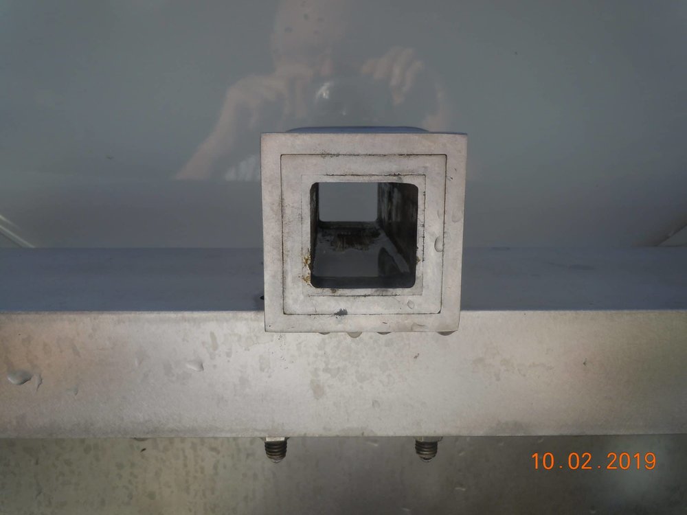

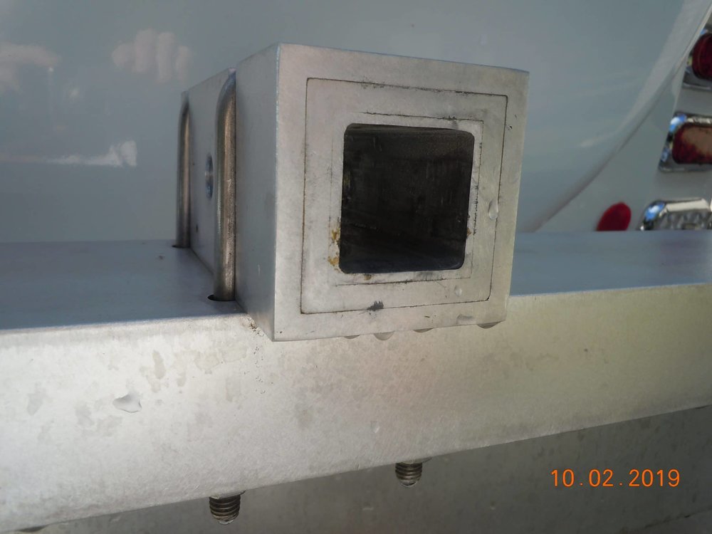

Trainman Posted October 2, 2019 Author Posted October 2, 2019 John, It's probably too much work needed to get the pieces apart, when all I need to do is purchase a short 2" receiver and put a piece of thin hard rubber between the two. I did take a pic of what it looks like, upon inspection they used 3 tubes to make the 1 1/4" receiver, I guess there shop needs something to do at times. Here is how it looks, I see no welds used, but it's a very tight fit for sure. One last note, we will be at Oliver on the 7th of October to get the water heater working again on LP gas, it's not really out of our way as we will be camping in Tennessee that week, so I can pick Jason's mind with several questions on things that are not so much common knowledge, I'm making a list. trainman 1 2019 RAM 1500, 5.7 Hemi, 4X4, Crew Cab, 5'7" bed, Towing Package, 3.92 Gears. Oliver was sold.
ThomB87 Posted October 2, 2019 Posted October 2, 2019 Let me know what you find out. Just pick ours up. My intent is to do the same. i ordered the receiver from OLiver an will need to modify it to fit my existing bike rack. My thought was the same remove the sleeve and replace it with using a rubber insulator with a steel one. Cannot find any aluminum ones. I have plenty of old bike inner tubes. When I asked why not a 2 inch I got a song and dance discouraging people from too much weight. Seems to be an attempt to idiot proof. Looking at it I do not see any welds. Looks like it is just held on by the U bolts. Bill Thomas 2017 Tundra SRf5 4x4 Hull 534 Bill Thomas 2019 Elite II Hull # 534 2020 Chevrolet Silverado HD 2500
