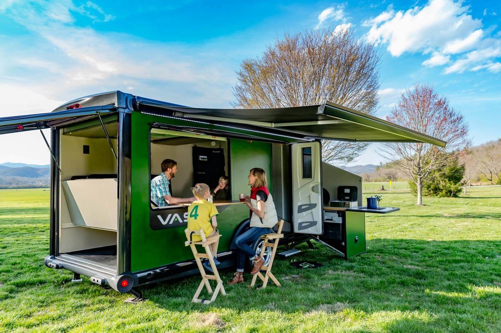

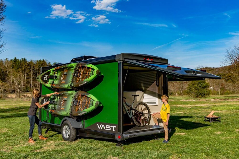

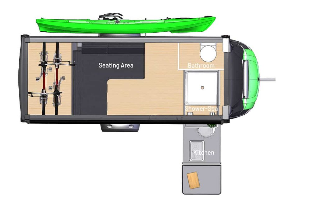

This is available for pre-order for a base MSRP of $46,000.
https://www.sylvansport.com/vast/
That is definitely not a standard cookie cutter RV, but I have some huge doubts about it......
500 pound cargo capacity.
No holding or water tank capacities listed.
”2 batteries” but no mention of solar. It does have a roof AC so I guess it must have shore power.
7.9 foot width, fender to fender, but they expect you to hang bulky kayaks on the street side wall?  The 200 pounds of off-center weight will make the trailer sag left, and there is risk of sway in gusty winds. You risk ripping them off onto a passing vehicle, and you could not see past them from the TV. If your load made the trailer more than 8’6” wide you would need an oversized permit for every state you travelled through....LOL.
Long skinny slides for the nose cargo bin and kitchen, how sturdy will those be?
Huge amount of openings, they reduce the structural strength and the seals will inevitably leak dust and water.
Low ground clearance.
Plastic parts will fade and crack, will replacements be available in ten years?
Proprietary extruded aluminum caps and exterior frame for the structural panels. What happens when one gets damaged?
The shower is only usable when the kitchen slide is extended.
No built-in storage other than a small area under the galley and the front cargo bin.
I should probably stop here and let somebody else find some more issues..... would you rather have an Ollie Elite or this .... thing?
At half the price, it would be interesting.
The sliding kitchen is pretty innovative though. I’ve see a few other trailers try to do a single indoor/outdoor kitchen but this is the first one that seems to keep the kitchen at a usable height either way.
I’ve seen their little pop up tent trailer in person and it’s pretty cool for a light-use trailer.
