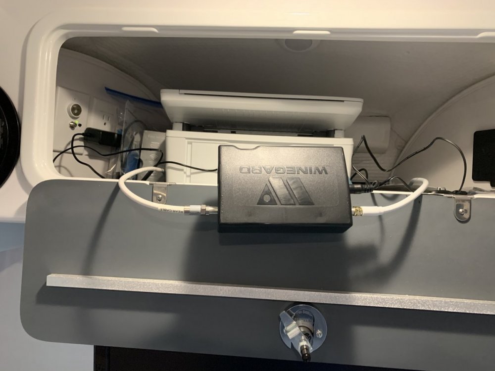

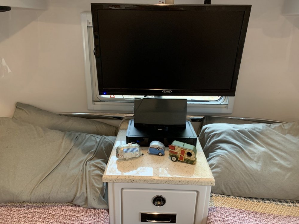

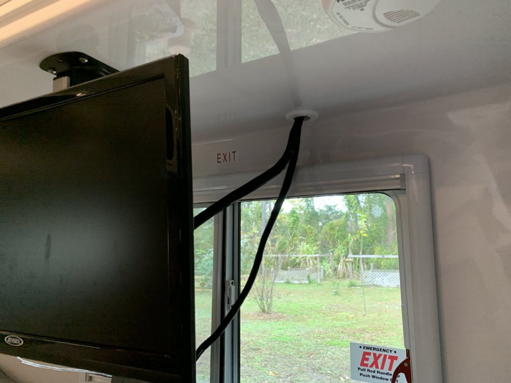

KWRJRPE Posted December 8, 2019 Posted December 8, 2019 I am not following this conversation (in other words, I am confused), so I will attempt to describe what I have setup. I have a 2019 Oliver EII and recently added a Wineguard G3 DirecTV just as you described (purchased equipment and pay $7 per month for extra receiver). LOVE IT! The way I connected my DirecTV: in the attic Oliver provided a coax cable (from the satellite connector on street side of the outside) and an HDMI cable (from the television). I connect the Oliver coax to the Wineguard power box, then fished a new coax from the power box down through the same hole as the television cable wires that lead to the television. I also fish the HDMI cable from the attic through the same hole and connected both the coax and the HDMI to the receiver. This now completes the coax cable connection from satellite dome to Wineguard power box to receiver and receiver HDMI back to television. The power needed to power the G3 satellite dome runs from Wineguard power box back through Oliver coax to street side connector to G3. I leave the receiver on my nightstand table and plug it into one of the AC outlets near the nightstand table. I plug the Wineguard power box into the AC outlet in the attic. Attached are photos showing my arrangement. Very easy, no need for switches or fishing cables (other than pushing cables though same hole used by television cables from the attic). KWR 2019 Oliver Legacy Elite II, Hull#444 2019 GMC Sierra 2500HD Crew Cab, 4WD, Denali, Duramax 6.6L Turbo Diesel V8 Engine with Allison 6-speed transmission
