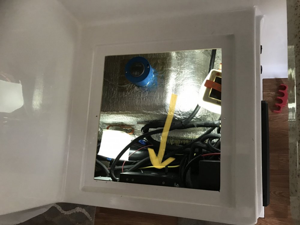

The inverter is located under the street side bed and the surge protector is under the rear seat of the dinette.  You will have to remove 2 screws to access that area.  Yellow arrows point to the inverter and surge protector.
The inverter changes DC power to AC power allowing you to run something like a toaster on the battery power of the trailer.  The surge protector protects the trailer from incorrect AC voltage coming into the trailer, whether it is to high or to low, from whatever you connect it to.  That is why it is the first electrical component on the AC power line in the trailer.

Surge Protector
Inverter
