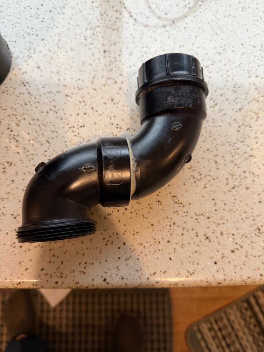

Just discovered I have a similar leak at the lower threaded fitting below the shower on the downstream side of the p trap.  Any update on how to proceed?   Called Oliver and they indicated they can't really help me source new PVC pieces so I can fix myself.  The larger PVC is for the black tank drain that inserts into the black tank.   Has an o-ring section that appears was broken due to over tightening during the build.  Not really an issue for us as we have compost and do not use the black tank for anything.  Would like to replace with new if I could find the PVC piece and rebuild to it would be as good as new.
As for the p trap, not sure if it is leaking at the lower fitting or has a hairline crack somewhere.  The hard to find piece is the connector that attaches to the shower drain.   Any advise would be greatly appreciated.
Will head to a larger hardware store (Lowes and/or Home Depot) to see what I can find to rebuild.

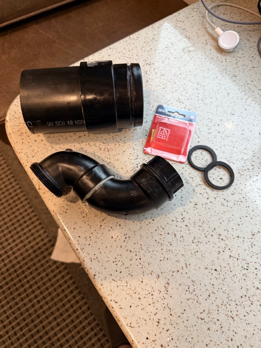

Happy to report I was able to source a new gasket for the connection between the Shower drain and the ABS piping.  It is called a "Coupling Washer 1-3/4" OD 1-3/8" ID" and can be purchased at a local hardware store for less than 2 bucks.  Upon replacing the coupling washer and reinstalling the p trap with a little bit of pipe dope on the lower connection, I am happy to report it no longer leaks.
BTW:  I did have to remove the 3" Black Tank connection to provide me with enough room to get the p trap out and back.  Also recommend you get a small strap wrench to loosen and tighten the drain p trap as it is really hard to reach and twist.
In case anyone else find that they need the adaptor fitting that goes into the poly black tank, I was able to cross reference a partial part number and come up with the name as an ICON Technologies Limited Model # 12511 Holding Tank Fitting 3" Hub Fitting.  It is available on Amazon for less than $10 or on camping world's website for around $5.
Also note that Oliver service indicated that they have changed this drain design several times since 2017, so your setup might be much different and require other parts.
