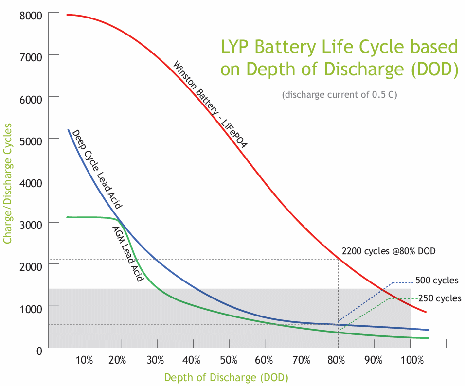

1 hour ago, LiFeBlueBattery said:
You can fully discharge (100% DoD) our battery without harming it also. Our low voltage cutoff happens when any cell group drops to 2.8V. The battery will enter sleep mode by disabling the MPU including Bluetooth. Current draw is reduced to 0.0005 Amps (5 micro-A).
That is great information. Stuff like that should be on your website! Seriously consider hiring a web developer and adding more technical information. The current site made me seriously consider how I might spend $4,000 elsewhere. 🤪
A lot of the early battery management systems would actually kill lifepo4; parasitic drain from WiFi, Bluetooth, LEDs, etc.
I really appreciate you taking the time to answer most of these questions.
