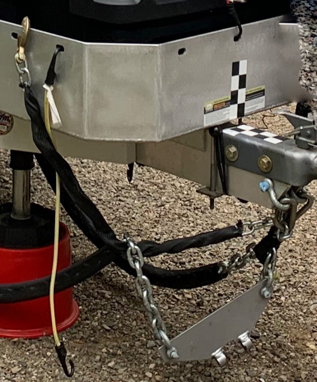

I have an F150 with a connection point way under the bumper.
While the coiled cable chains worked well, I wanted to change to make it a bit easier to connect.
I've added the following chains, along with a woven cover.
2x - CURT 80302 35-Inch Trailer Safety Chain with 1/4-In Clevis Snap Hook, 7,800 lbs Break Strength
I saved my previous cable chains in my backup box.
1469453911_ScreenShot2020-09-23at12_33_14PM.thumb.png.521bdd9a7f736fed1e78091b3045202a.png
