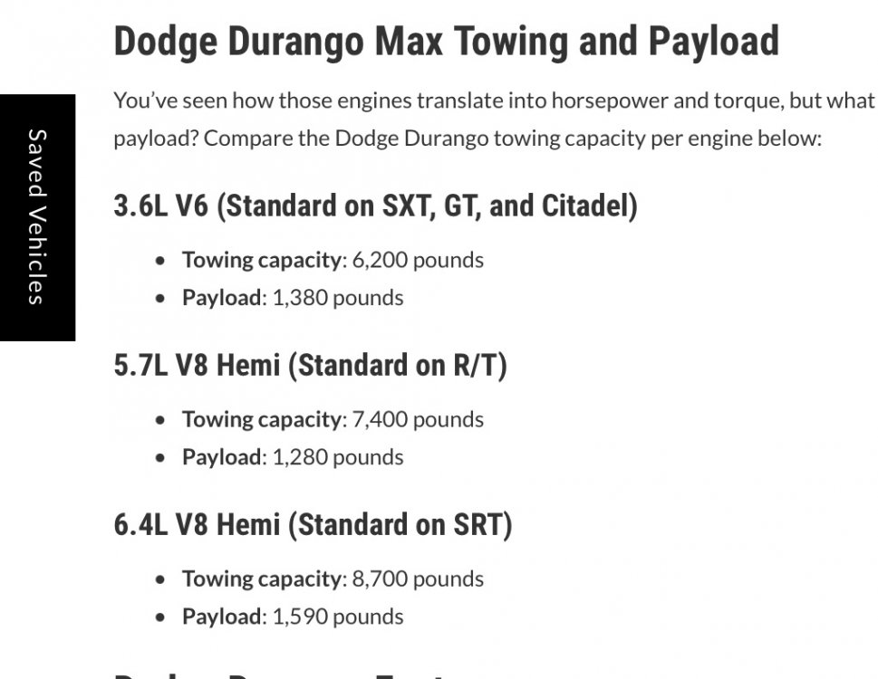

IMHO an SRT would be great, the 6.4 is quite a beast, and that model has a very good payload. The 5.7 would be marginal, due to its inadequate payload, the V6...... well, no.

As John said, the 5.7 looks ok for towing but a little marginal for payload.  And check the actual cargo/payload sticker on your Durango.  It’ll usually be on the driver’s door jamb.  The payload varies based on how your Durango is optioned.  Everyone tends to look at towing rating, but cargo/payload is the overlooked limiting factor for most people towing with SUVs or even 1/2 ton pickup trucks.  The tongue weight of the Oliver (500 to 600 lbs. depending on Oliver options), driver and passenger weight (and be honest 🙂), luggage, camping gear, a toolbox, a cooler, etc. put in or on the tow vehicle all count towards the payload limit.  Even the weight of the Andersen hitch has to be counted (about 50 lbs.).  Your sticker will tell you your specific limit.  It’ll look something like this with a max cargo / payload number.  This is my F-250.  3,334 lbs payload.  We carry a lot of stuff when camping, so we are probably around 2,000 lbs. when traveling.  I like to have a nice safety margin.

Where you tow also is very important, you can get by with a less capable tow vehicle if you never get into really strenuous conditions. Somebody who never left Florida might find the V6 to be acceptable, but the first steep mountain grade would reveal how very bad a choice it is, plus that engine has to be revved really high, the peak torque is at about 4000 rpm. A screaming engine is hard on the passengers nerves..... the 5.7 is perfectly fine for power, you just won’t be able to carry very much of your “stuff”, especially if there are more than two normal sized people. If there are four adults, then you won’t be able to bring ANY gear inside it.
