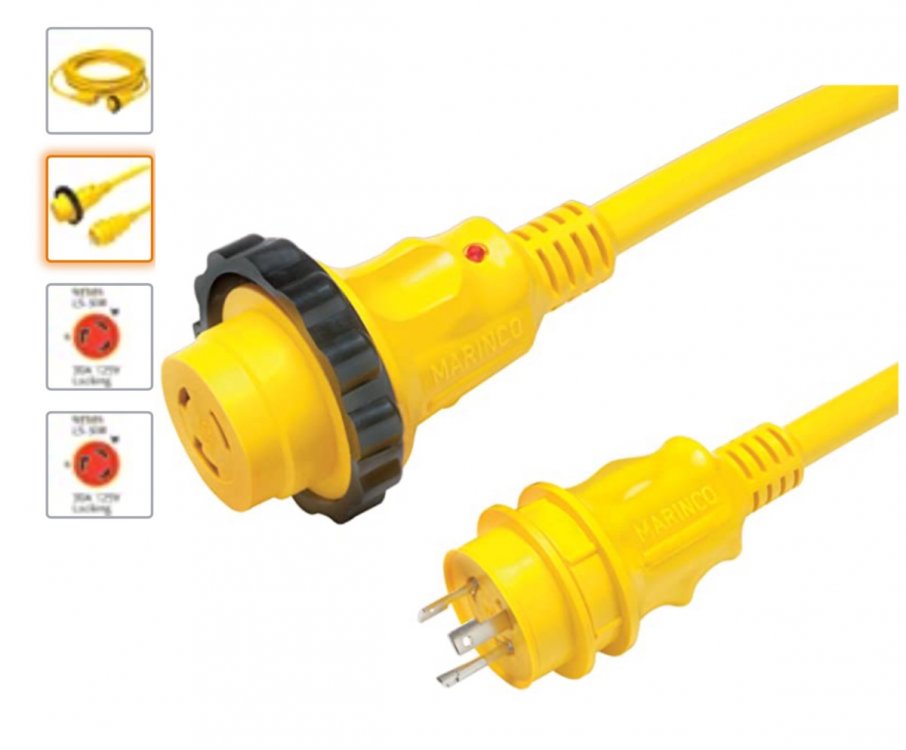

The problem with a regular RV male plug is that it doesn’t have a lock ring, so all the stress is on those weak, soft plastic and brass inside parts. So traveling with one of those connected is not at all good for it, nor is it good for the generator connection! I found a good marine cord, 12 feet long. I doubt that anybody makes one shorter with the correct marine plug.
Marinco 30A 12 feet
