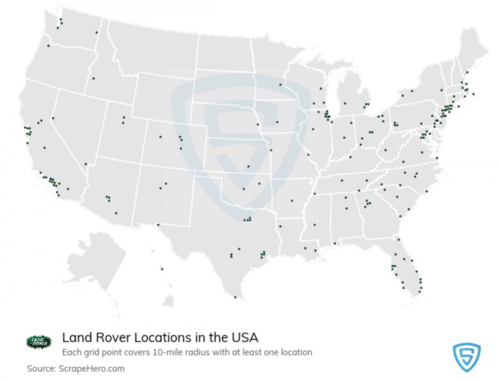

You mean the Land Rover isn’t as reliable as your Land Cruiser? 😉
One more....
Edited by John E Davies
