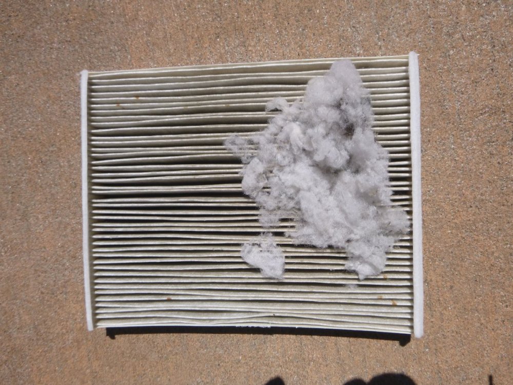

Moderators topgun2 Posted March 27, 2021 Moderators Posted March 27, 2021 My 2017 Ford F-150 only has 31,000 miles on it. But, I decided that it was time to replace the cabin air filter and with temperatures in the mid to high 70 yesterday it was just about the perfect day to do this small job. After watching several YouTube videos on the subject, I got out my automobile trim removal tools and a 7mm socket and got to work. Perhaps because this was the first time various parts of the dashboard had been removed it seemed to take a bit more force than I expected to get the trim to "pop" loose. But all went as planned until I removed the old air filter and found this: My first thought was that a rodent was building a nest. But there are no signs of droppings, chew marks or any other of the usual rodent calling cards. In addition, there is no sign of any of this type of "insulation" material anywhere near the dash. My best guess is that it has been there since the truck was built. Given the dirt roads I've been down and the general environments I've camped in, I'm a bit surprised that this filter wasn't even dirtier, but, I'm still very glad that I replaced it. Bill 1 1 2023 Ford F150 Lariat 3.5EB FX4 Max Towing, Max Payload, 2016 Oliver Elite II - Hull #117 "Twist" Near Asheville, NC
John E Davies Posted March 27, 2021 Posted March 27, 2021 Maybe cottonwood seeds? Those look similar and they do make a real mess. My daughter’s Outback had a huge mouse nest, blocking about 90% of the airflow. Yuck, fortunately no signs of chewed wires, just grass and fur. Regardless, you should be changing that filter annually. Cheap generics are fine if changed frequently. John Davies Spokane WA SOLD 07/23 "Mouse": 2017 Legacy Elite II Two Beds, Hull Number 218, See my HOW TO threads: Tow Vehicle: 2013 Land Cruiser 200, 32” LT tires, airbags, Safari snorkel, Maggiolina Grand Tour 360 Carbon RTT.
Moderators topgun2 Posted March 27, 2021 Author Moderators Posted March 27, 2021 Nope - insulation and/or "stuffing" (as in for furniture) of some sort. Nothing organic. Bill 2023 Ford F150 Lariat 3.5EB FX4 Max Towing, Max Payload, 2016 Oliver Elite II - Hull #117 "Twist" Near Asheville, NC

bhncb Posted March 27, 2021 Posted March 27, 2021 (edited) That looks like a firewall insulation, sucked into the filter by the fan. Telltail evidence is likely upstream in the intake ducting somewhere. Edited March 27, 2021 by bhncb 1
