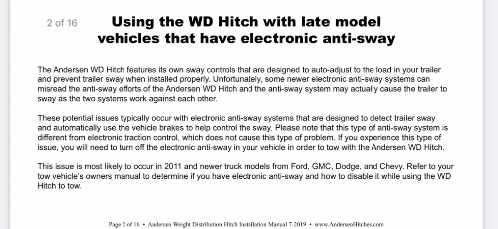

Frank C Posted April 9, 2021 Share Posted April 9, 2021 (edited) I voted. I’m towing with a Ford F-250. I don’t use the Andersen. My F-250, while generically called a 3/4 ton under the accepted truck classification naming, has an actual payload rating of 3,334 lbs. so I could easily carry 1 ton of payload and still have plenty of extra left over. My truck as optioned will tow 12,600 lbs and a tongue weight rating of 1,250 lbs. so no Andersen needed for weight distribution, and the truck has electronic trailer sway control as part of the towing package so I don’t need the Andersen for anti-sway either. The dual axle Elite II has proven to be very stable when towing. I’ve never noticed the slightest problem with trailer sway. Edited April 9, 2021 by FrankC 1 3 Link to comment Share on other sites More sharing options...

Frank C Posted April 9, 2021 Share Posted April 9, 2021 (edited) 12 minutes ago, RunninOnMT said: I voted as well. We tow with a 2019 GMC Sierra 2500 and we use the Andersen hitch. The only reason I do so is because using it makes my wife "feel" better. Maybe someone can chime in with some talking points that I can use to convince her we can do without it??? 😬 Check if your truck towing package has any electronic anti-sway function. If so, the Andersen hitch instructions say to not use the Andersen hitch with any active tow vehicle trailer sway control. Here’s the section from the Andersen instructions. That may give you the info you need to convince your spouse (but you didn’t hear it from me, I don’t want to cause marital issues 😆). Edited April 9, 2021 by FrankC 1 Link to comment Share on other sites More sharing options...
