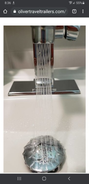

Moderators SeaDawg Posted May 26, 2021 Moderators Posted May 26, 2021 While you're at it, remove the aerators, soak and clean them in a small cup of vinegar solution, rinse, and don't replace them til you have thoroughly flushed the system, including running crud out through the faucets with a new tank of fresh water . The aerators are probably caked, too. The fine screens would trap everything you're cleaning out of the system. We've replaced our aerators with low flow aerators, to save water. At home, too. Overland found this really cool NeoPerl Mikado aerator. I copied him, right away, in the house. The spray pattern is like a basketball net. Saves a lot of water. 2008 Ram 1500 4 × 4 2008 Oliver Elite, Hull #12 Florida and Western North Carolina, or wherever the truck goes.... 400 watts solar. DC compressor fridge. No inverter. 2 x 105 ah agm batteries . Life is good.
