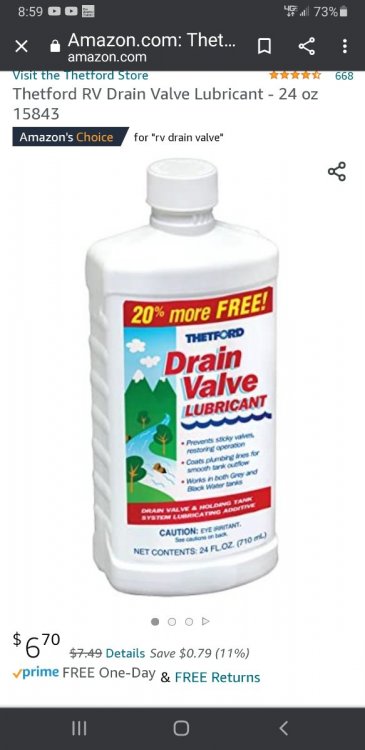

Husband reported leakage the last time we dumped the tanks.  Will try flushing out the black tank and adding some blade lubricant and see if this fixes the problem before inspecting the valves.

Try this when your tank is empty, so it actually gets down to the valves.
