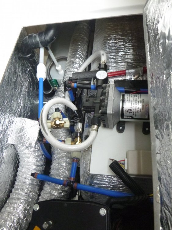

Moderators topgun2 Posted March 7, 2020 Moderators Posted March 7, 2020 I've added a bunch of "extra" insulation in my Ollie. Every inch of both hot and cold water piping has been covered with foam insulation. My original intent here was to help reduce noise from the water pump, but, I believe that this has also helped with retaining the "heat" of the hot water. Given that I had some insulation/sound deadening material left over in the shop from trying to lessen road noise in an old pickup truck, I then moved onto insulating those "trap doors" that give access to the areas between the hulls. This really helped in reducing water pump noise and even some minor condensation that I was having under the sleeping mattress. Next on the agenda was placing additional insulation (Reflextix this time) on the inside of both the exterior shower door and the outside basement door. This required adjusting the latch and the addition of some standard foam type stick on ribbon insulation (think of the material used for sealing drafts in windows). Finally, I got into the bowels (as much as I could ) between the hulls and put additional Reflextix anywhere I could stick it - heck, I had the material so why not use it? I even got to the point of using a roll of the silver "aluminum" heating duct tape to seal around where wires go through the existing insulation and/or where various "panels" join to one another - such as the panel that separates the basement area from the area containing the street side rear jack. I'm really not too sure that all of this work has resulted in a more energy efficient Oliver, but, the water pump noise is somewhat less, dust/dirt infiltration in the basement door area is greatly reduced, excess materials in my shop have been cleaned out and it made me feel good when the guys in Service were impressed with the job. In this picture note the silver insulation on the "trap door" on the extreme right of the picture and the extra layer Reflextix over inside of the wall on the extreme left of the picture (the "flap" of extra insulation that was cut out and then left to rest on top of the heat duct is the dead give away). This is also before I started to insulate the pipes. Bill 2 2 2023 Ford F150 Lariat 3.5EB FX4 Max Towing, Max Payload, 2016 Oliver Elite II - Hull #117 "Twist" Near Asheville, NC
John E Davies Posted March 7, 2020 Posted March 7, 2020 It is so cool to see a 12 year old thread revived. I would caution about going overboard by insulating everything that you can touch; consider what it will mean for future servicing, such as identifying and fixing a water leak, or removing an item for repair. I do really like the idea of adding stuff under the cabin access hatches, but since there is a great big return air opening for the furnace on the LEII model, I am doubtful it would actually quiet down anything under that area.,.. John Davies Spokane WA 1 SOLD 07/23 "Mouse": 2017 Legacy Elite II Two Beds, Hull Number 218, See my HOW TO threads: Tow Vehicle: 2013 Land Cruiser 200, 32” LT tires, airbags, Safari snorkel, Maggiolina Grand Tour 360 Carbon RTT.
