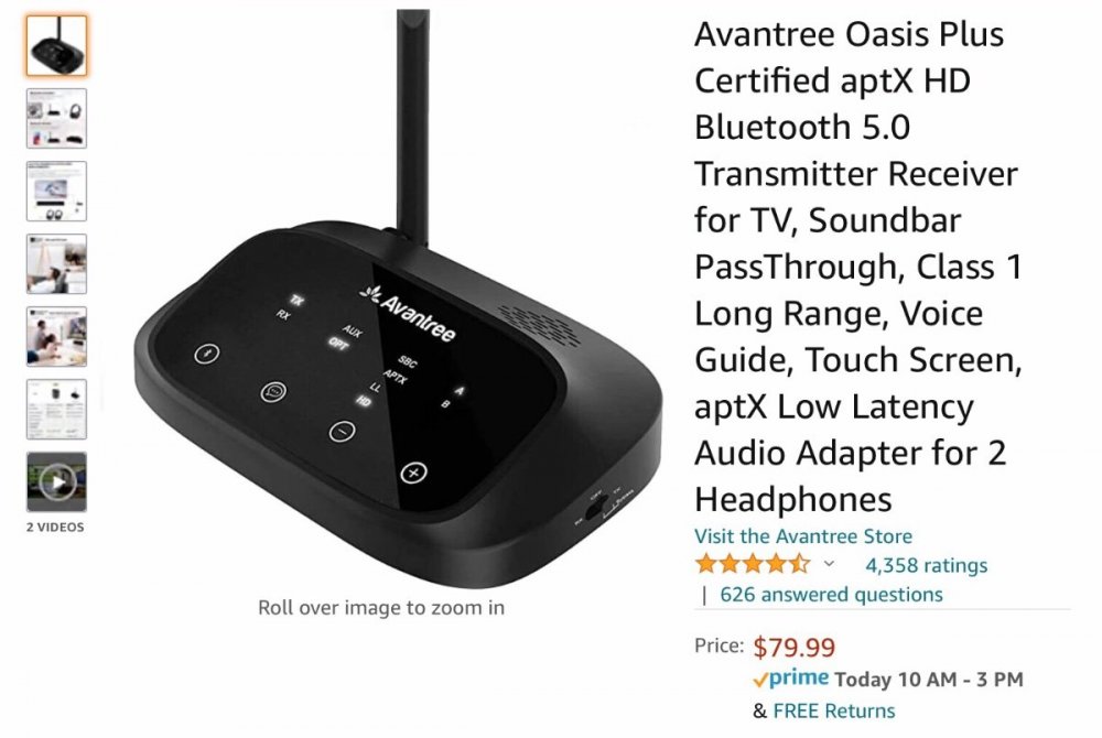

I can transmit Bluetooth from my phone or tablet to the Furrion radio without any trouble.  But I use this to transmit Bluetooth from my SiriusXM satellite radio to the Furrion radio or Bose headphones.  I also use one at home from my LG tv to Bose headphones.
So this is a solution if you can’t connect the tv to the radio with wires or cables.

Is the tv mounted under the attic or sitting on the nightstand?  If it is mounted, you may be able to connect it to Oliver radio by cables.  If not, the picture I forgot to add has now been added, so see my previous post.  This device would work in either scenario.  You could also use it with any of the portable Bluetooth speakers and set the speaker near wherever you chose to sit.  Or use a headset or a pair of headsets for 2 people.
