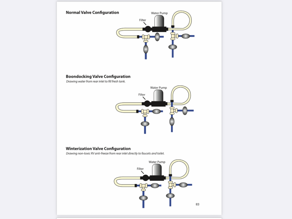

Moderators mossemi Posted August 23, 2021 Moderators Posted August 23, 2021 I am known for asking silly questions, so please don’t be offended. When I look at the 2017 plumbing diagrams, I don’t see how the water from the city water inlet can reach the freshwater tank unless the valves are in the wrong configuration, they are defective or it is flowing backwards through the pump. Am I missing something? Mossey 2 Mike and Krunch Lutz, FL 2017 LEII #193 “the dog house”
Overland Posted August 23, 2021 Posted August 23, 2021 8 hours ago, mossemi said: Am I missing something? Nope. If water is getting into the tank from the city water port, it has to get through either the valve or the pump. That, or your ports are mislabelled. 1 1
Moderators SeaDawg Posted August 23, 2021 Moderators Posted August 23, 2021 Sorry for misreading your problem, @Windwalker. I think Overland and Mossemi have offered good information. 2008 Ram 1500 4 × 4 2008 Oliver Elite, Hull #12 Florida and Western North Carolina, or wherever the truck goes.... 400 watts solar. DC compressor fridge. No inverter. 2 x 105 ah agm batteries . Life is good.
Windwalker Posted August 24, 2021 Author Posted August 24, 2021 My understanding is in the valve configuration for using the water from the water tank with the pump you can also use the city water am I missing something here. Thanks to all that have commented to this post.
