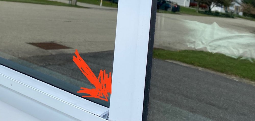

Can you clarify some details?  Are you just seeing water in the window track?  Or is water leaking down onto the mattresses, etc.?   The window tracks do get some water in them when it rains, but it normally drains out the weep holes and does not overflow the track into the interior of the trailer.  That's just an unfortunate effect of the design of the sliding windows.  Make sure your seals around the outside of the sliding window are properly in place, and make sure the end of the seal is butted up snuggly against the vertical center bar of the window to minimize the amount of water that can get past the seal.  The seal sometimes shifts in the track and creates a gap there.   See photo for an example of the gap if the seal is shifted away from the center bar.

If the windows are closed and it is raining you should not have water inside.  Some water in the window tracks is normal but it should not be past that.  SInce your trailer is new and you haven’t camped they window tracks should be clean.  As Frank says above, check your rubber seals.  They are fully removable (I take them out after every trip for cleaning).  Is the water just in the window tracks?  Mike
