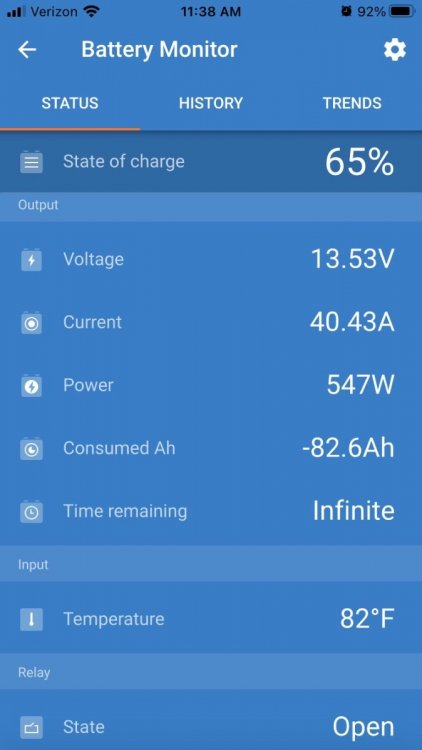

The Victron shunts are great, that particular model, maybe not. I have read that in the past it has major Bluetooth connectivity issues.. But that may have been resolved. The one with remote display (BVM-712 Smart) doesn’t have any problems. Mine works from 75 feet away through four sheet rocked walls. Be sure to add the optional supply power/ temp sensor cable. It replaces the included single wire power cable.

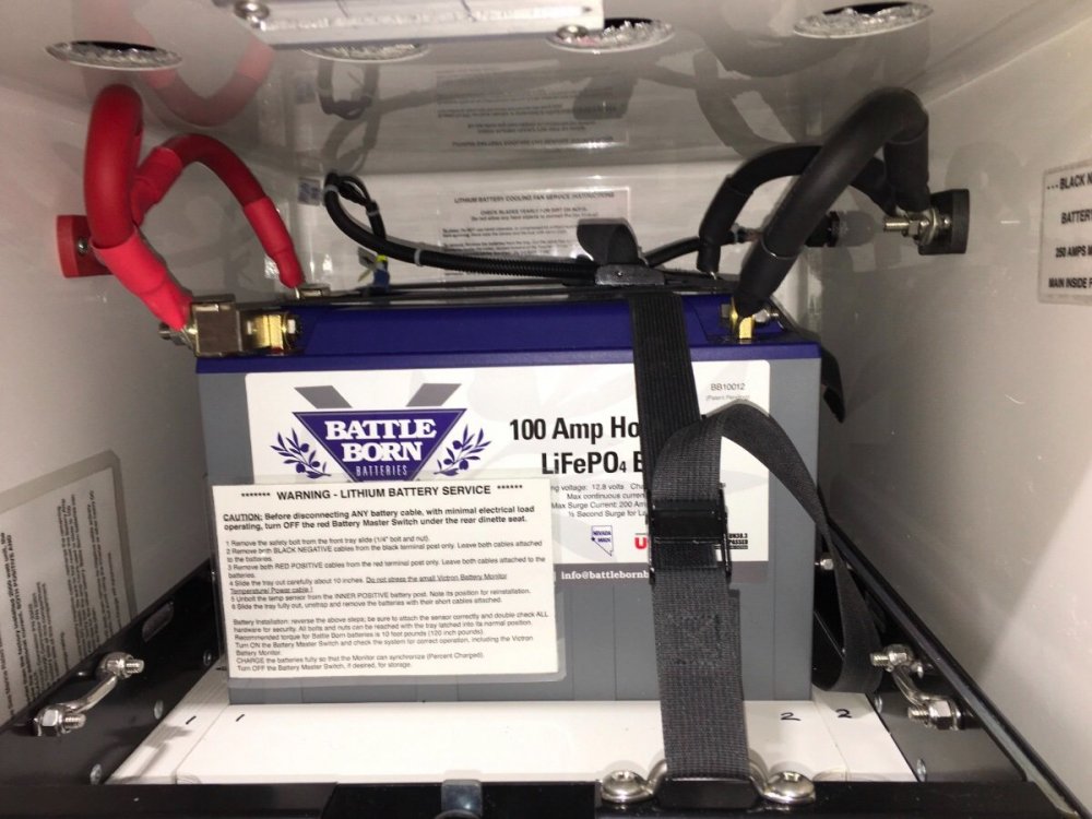

That factory wiring is a mess, ain’t it? Move everything inside to common bus bars or posts, it will be easy because you have no fat inverter cables. Put the smart shunt inside next to your new buses. I check my cables AND straps for security every week when traveling, it takes no tools; unlocking the door, opening,  feeling for looseness, closing and relocking takes about twenty seconds.
https://olivertraveltrailers.com/forums/topic/5377-how-to-battery-feed-through-post-installation-reduce-the-clutter-in-the-battery-box-lithium-batteries-only/

That is not a stock setup, but I suspect that yellow wire goes directly to the main grounding buss bar.
I definitely agree with John, move everything inside to common buss bars. Get rid of all that clutter.

Based on my experience with Victron devices equipped with Bluetooth radios, the connectivity depends on where you place it.  The Bluetooth radio with the BMV-712 is in the display, so your install with the display in the upper cabinet area has much better  connectivity than mine which is in the lower hull.  I doubt your charge control Bluetooth coverage is as robust as your 712.  I experimented with my 712 before placing it in the lower hull and quickly realized I would be giving up at least 50% of the Bluetooth coverage if I placed below decks, but I planned on using the app and not the display from the start.  I don’t think a Smart Shunt installation is viable any place but the lower hull.  And the Bluetooth radio for the Smart Shunt is mounted to the shunt itself, so it’s inevitable the coverage is going to have a smaller footprint than a 712 installation with the display mounted high in the Oliver.
