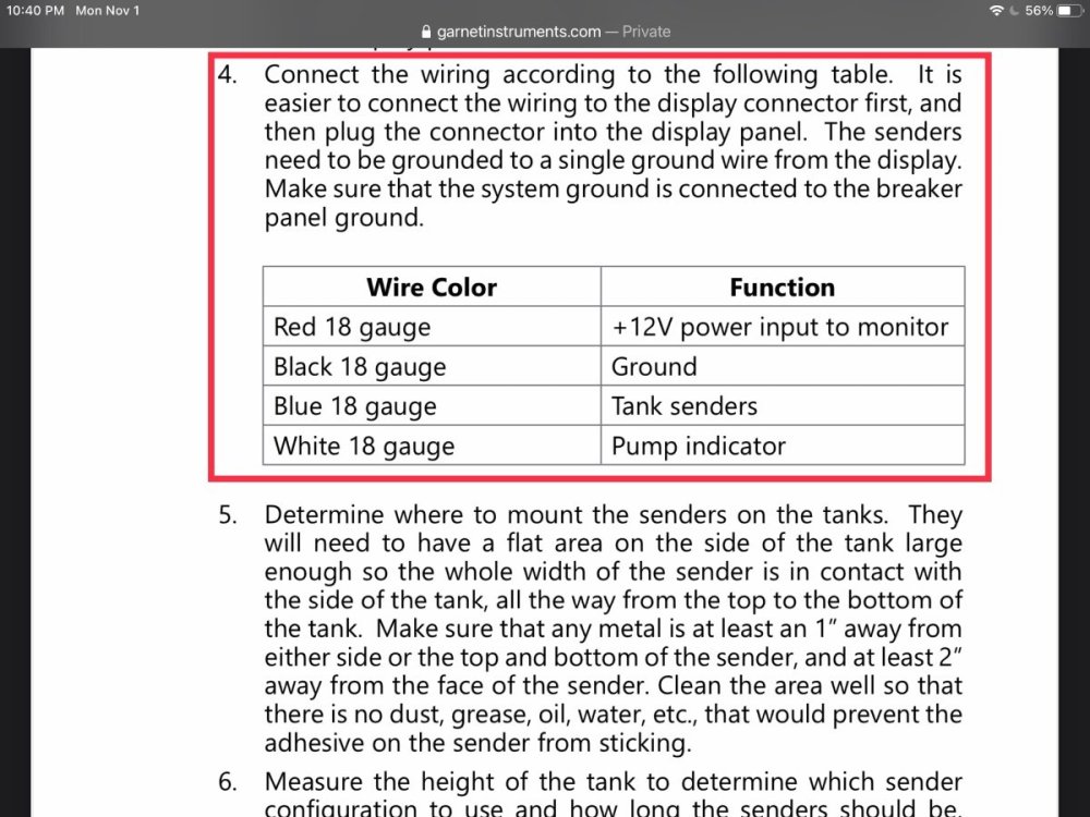

The following screenshots are from the SeeLevel II manual.
It looks like there are 2 power wires to the panel.  One for the display and one for the pump and the pump circuit is working ok.
The picture below shows the character in your picture and it’s a T.  And the solution is to see the wiring diagnostic section.   Seems like good place to start since you reinstalled the batteries.
You should be able to access the back of the display through the pantry to verify the panel wiring connector.

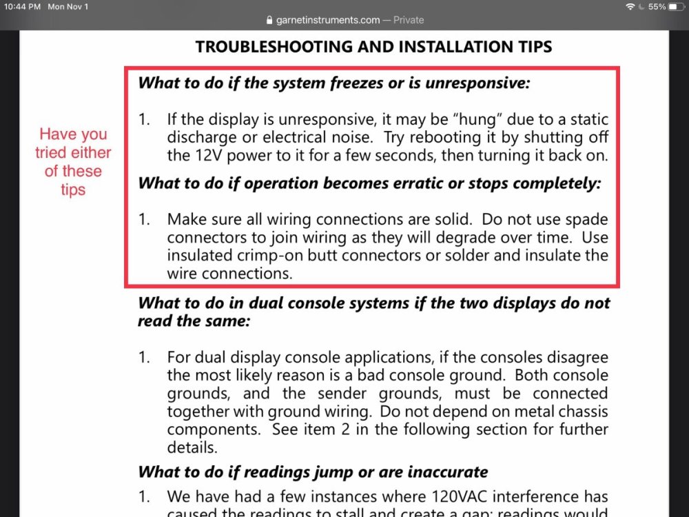

This last picture picture references frozen or unresponsive displays.
Good luck!
Shutting off the 60A breaker to the batteries for a few minutes did the trick.. thanks Mossey
