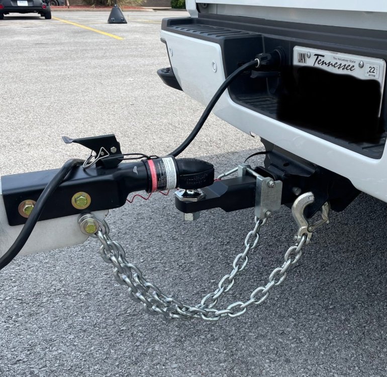

Townesw Posted November 18, 2021 Posted November 18, 2021 If you are determined to use the Anderson you can use a sleeve (it’s there, you can’t see it) on the shank and a Hitch Vise to eliminate the rattle. I used this set up (without the chains and plate) on my 3/4 ton until I had a custom ball mount made. I still use the Hitch Vise with my 2.5 inch ball mount. It’s machined from a solid piece of 1018 CR steel square stock. The setback on it is 1 inch shorter than the Anderson mount, and I may reduce it more. It has a 5/8 inch drop as shown and a 7/8 inch drop if flipped. With truck and trailer loaded the trailer rides slightly nose down. Bill and Martha 2018 LEII Hull 313 Original owners 3/14/2018 2019 Chevrolet 2500HD Duramax

John E Davies Posted November 18, 2021 Posted November 18, 2021 32 minutes ago, Townesw said: FYI, place a 12 inch bungee cord on top of the ball mount, and hook the ends to your chains. No more dragging and rusting! That is a nice clean setup, I like it. John Davies Spokane WA 1 1 SOLD 07/23 "Mouse": 2017 Legacy Elite II Two Beds, Hull Number 218, See my HOW TO threads: Tow Vehicle: 2013 Land Cruiser 200, 32” LT tires, airbags, Safari snorkel, Maggiolina Grand Tour 360 Carbon RTT.

Townesw Posted November 18, 2021 Posted November 18, 2021 I used Columbus McKinnon 3/8” G70 clevis slip hooks (WLL 6600 lbs) because they fit the holes in the hitch and Columbus McKinnon 3/8” G70 transport chain (WLL 6600 lbs) because it fit the hooks. I had some stainless steel spacers turned to 1.360” diameter, one at 1.740” long, two at 0.55” long, and two at 0.30” long. A hole bored through the spacers fits a 1/2 bolt. The 1.740” spacer just slips inside the tongue when the hitch bolts are loosened. The bolt is a 1/2 inch grade 8 because I didn’t want to enlarge the holes in the tongue. The unthreaded portion of the bolt extends almost to the outside edge of the last SS spacer. The middle photo shows the bolt before I shortened it and a regular nut for fitting purposes. I cut the excess threads off, secured it with a new Nylock nut and covered it with a new Radolid VCI nut cap. 1 Bill and Martha 2018 LEII Hull 313 Original owners 3/14/2018 2019 Chevrolet 2500HD Duramax
