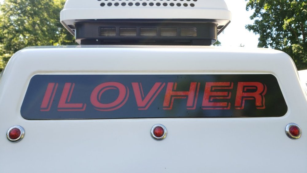

Since you bought your Oliver used, have you ruled out a water leak as the source of the moisture you are seeing? The illuminated Oliver logo above the rear window is a potential leak point into that attic area where the television wiring is.
This was removed, properly sealed and modified last summer
