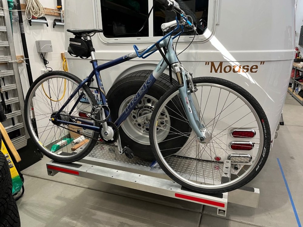

My wife is shopping for an ebike, I will be mounting a single 1-Up Super Duty roof tray onto the back of “Mouse” in place of the existing cargo box, it will simply bolt down to the cross beam. Test with my old Trek “analog bike” circa 1998. We will be carrying just one bike, for her use, though I may poke around on it a little. I have neuropathy issues…😤

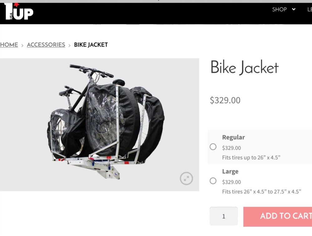

Has anyone found a solution for a cover that doesn’t flop around and/or completely block the trailer lights? 1-Up sells one with clear windows for the wheel parts, but it is $329 😳

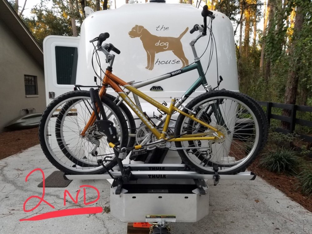

If not a full cover, do you use anything over the seat, drivetrain or rotors to keep crud off them? Remove the seat and post, along with the battery? How do you keep crud out of the open battery compartment? This ebike stuff is new for me, I haven’t carried bikes for over 20 years and that was on top of a hard top utility trailer. Pictures or links would be most welcome. I do have a pic of Pete (and Bosker)’s setup, maybe you can post some details? And did you ever post a full thread about your cool custom receiver?

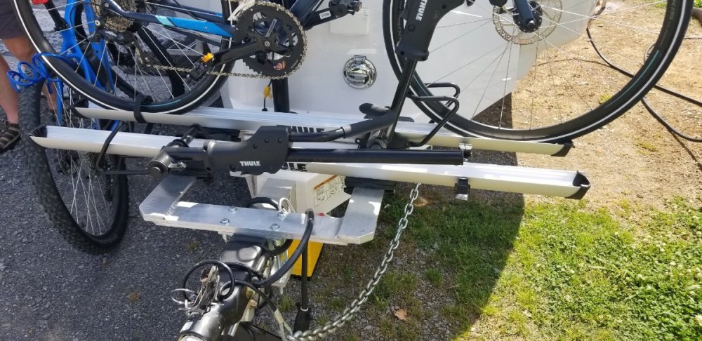

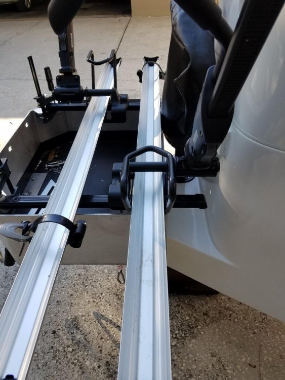

This was my second bike rack mount using bike racks I already owned.  Then I found a used BikeWing I could modify.  I was never comfortable with the reduced turning radius, but that shouldn’t be an issue for you.  The Andersen long shank ball mount helped, but the tray was unusable.

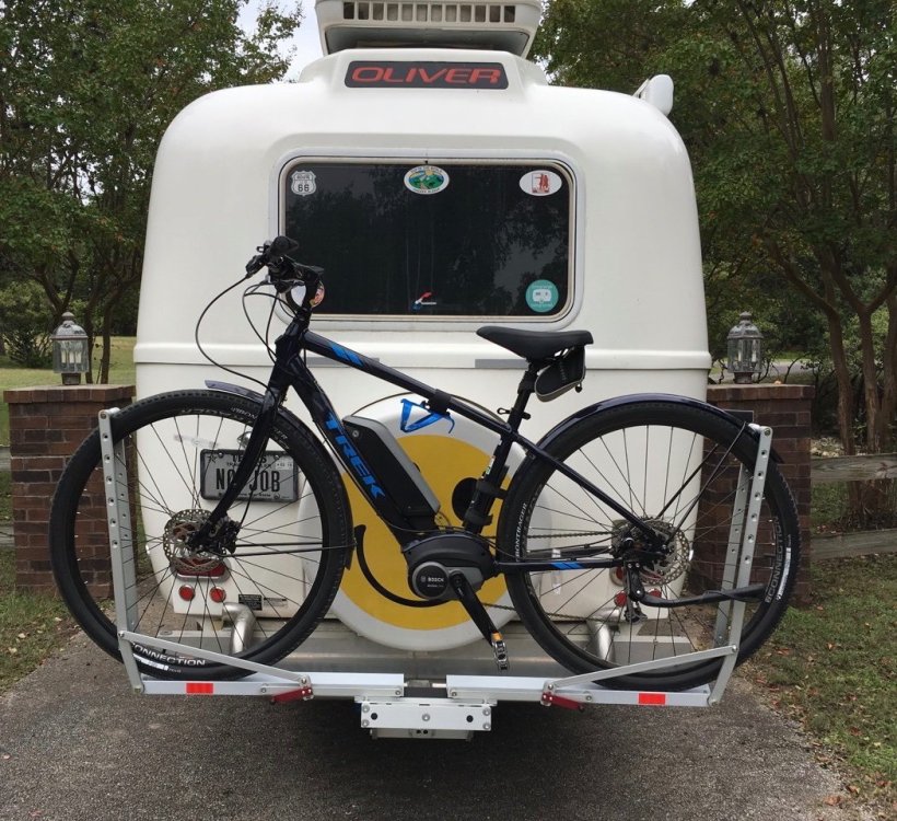

And here is a different mount.
Thanks - this pic?
20180507_150250.jpg.9af9765ac9cd31b0c7e3dd2065b11daf.thumb.jpg.0a4f893ae5989549ac49d8c9772f2de4.jpg
That is downright beautiful, and overbuilt even by my standards. It appears to be 2" x 3/8" plate, sandwiched a bunch of times for super rigidity. Pretty welds too. I guess if the intent is to have the bike trays act as the fuse in a collision or severe jackknife, to save the frame from damage, that sure would do it.

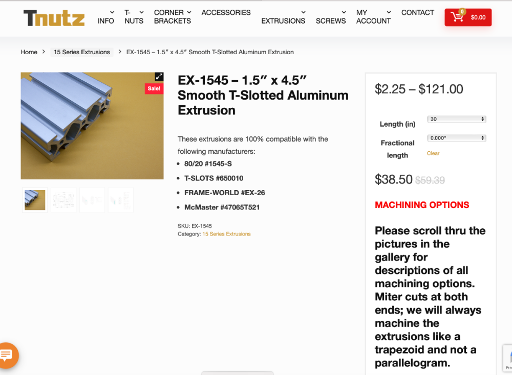

My intent, if it will work, is to use this stuff, securely bolted to the frame with stout backing plates, with the single tray bolted directly on top. The size approximates a 2" x 4" rectangular tube..
38743900_TnutzT-SlottedAluminumExtrusion.thumb.png.0bef689479c8d0729647b42cc144a7dd.png
It is super super rigid and very easy to work with, compared to welding a big support frame. These extrusions are used in overland expedition racks, they absorb a lot of abuse.
I’m pretty sure this was donthompson’s LEII at the Oliver Rally in 2018.  And you may remember that he sold his LEII and bought a Conqueror trailer and sold it and now has a Kimberley T3.
I think the 80/20 products will make a excellent base for a 1-Up.
Don pops in here every now and then.  You can PM him to see if it was his and he could probably answer any questions.  Mike

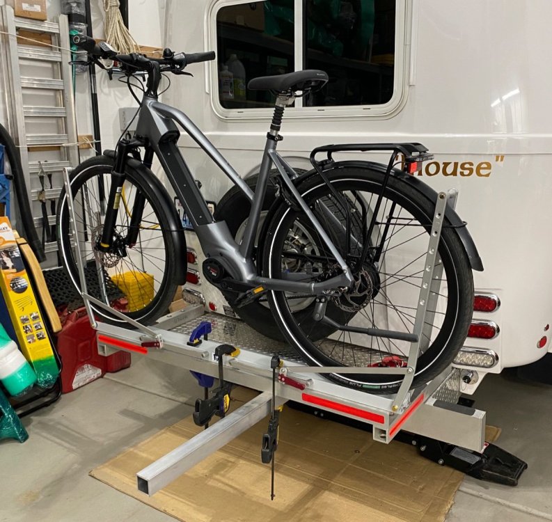

Updating, here is the new ebike….

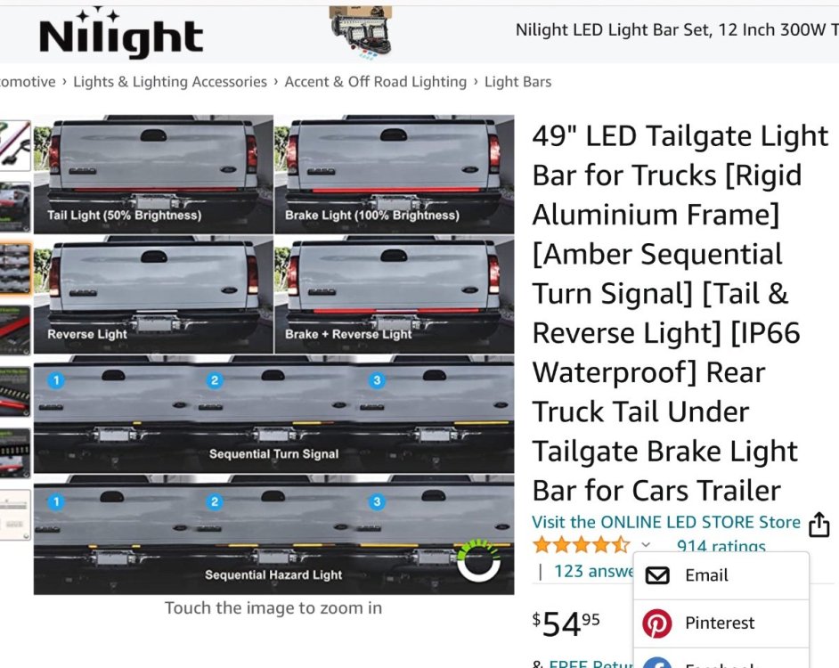

I am going to add two tie down extension arms sticking 12” out the back and a tie-down rail along the top of the sewer compartment opening. That way I can run straps to the seat post and to the stem. The 1-Up Super Duty tray bolts directly to the beam. The bike tires and aero rims definitely will block the trailer lights!, I am going to need an add-on light bar, to install on the crossbeam (where the red reflector strips are now). I found this one, it is very bright with central backup light and  SEQUENTIAL amber turn signals! Woohoo! The LEDs should add some welcome lumens when reversing the trailer at night.
49" LED Tailgate Light Bar for Trucks [Rigid Aluminium Frame] [Amber Sequential Turn Signal] [Tail & Reverse Light]
Before I order, has anyone use this, or can you recommend a more suitable one for around $50-$75?
BTW, the bike is a Gazelle Ultimate C380+, a fast Class 3 (28 mph pedal assist only) with 85 Nm Bosch mid-drive motor, Enviolo stepless hub, Gates carbon belt drive, four caliper brakes, and a 500 wh battery. We have steep hills everywhere - the main road just a half mile from our house is 14 to 16% - so my wife picked a bike with big motor, big battery and big brakes😬 I guess I am going to have to invest in some extra locks. … https://www.bicycling.com/bikes-gear/a37039662/gazelle-ultimate-c380-plus/
With the added lights I can cover the bike😬. Thanks for any suggestions,
