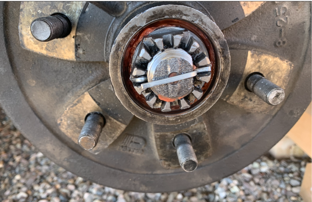

geO Posted May 16, 2022 Posted May 16, 2022 I had a bit of a struggle removing the old cotter pin. I cut down the new one and was wondering if how I replaced it is ok?
Moderators topgun2 Posted May 16, 2022 Moderators Posted May 16, 2022 George - Assuming that your grease cap will fit - snug all the way down to where the rim of the grease cap is basically sitting flush with the rim of the hub then it looks OK to me. Bill 1 2023 Ford F150 Lariat 3.5EB FX4 Max Towing, Max Payload, 2016 Oliver Elite II - Hull #117 "Twist" Near Asheville, NC
Moderator+ ScubaRx Posted May 17, 2022 Moderator+ Posted May 17, 2022 George, looks like a good job to me. I hate cotter pins, they always manage to slice open a finger. 1 Steve, Tali and our dog Rocky plus our beloved dogs Storm, Lucy, Maggie and Reacher (all waiting at the Rainbow Bridge) 2008 Legacy Elite I - Outlaw Oliver, Hull #026 | 2014 Legacy Elite II - Outlaw Oliver, Hull #050 | 2022 Silverado High Country 3500HD SRW Diesel 4x4
