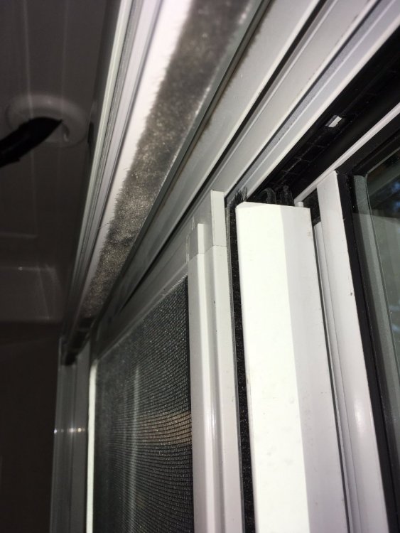

Alberta and Randy,
I had the same problem trying to figure out how to reinstall the egress window screen. The screen is mounted outside the widow channel using four metal clips. The clips snap into the edge of the plastic channel. Just hold the screen in place and push until you hear it snap. It took me several frustrating minutes to figure it out.

Seriously - a very small amount of wax, silicone, WD-40, petroleum jelly, etc on each of those 4 tabs will go a long way in helping to "snap" the screen back in place.
I always place the bottom in first and then tap the top of the screen near where those spring tabs are until it snaps in.

Thanks for all the feedback ya'll!  I did not comprehend that the screen had those little silver extensions that snap to the frame.  Must pay closer attention to details next time, they matter!
Screen is in place and seems to be functioning.  The screen is missing one of the top silver extensions, but still seemed to attach.
