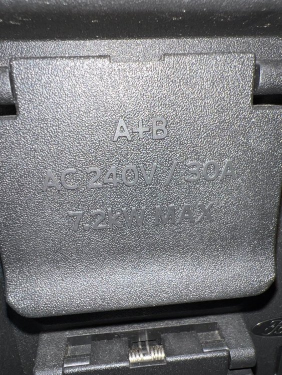

Kristie Mathis Posted June 8, 2022 Share Posted June 8, 2022 Hello! New owner of Hull #180 here! I have a 2022 Ford hybrid truck and would like to know what cord to purchase to plug my Legacy II in for A/C. The answer is probably simple but I am not in the same town as my camper at the moment.This is the plug in the back of the truck. If anyone has this set up an Amazon link would be wonderful! Link to comment Share on other sites More sharing options...
John E Davies Posted June 8, 2022 Share Posted June 8, 2022 This is beyond my skill set, but I know you will only be able to use half that rated current per “leg” if you spilt it into two 120 volt legs. You can’t pull 30 amps like from a proper RV socket. But you could plug a second cord into that second leg for some other load like a chainsaw while the trailer was getting power. https://www.f150gen14.com/forum/threads/anyone-figure-out-how-to-convert-240v-outlet-to-120v-and-still-use-all-7-2kw.3148/ Doesn’t Ford offer the necessary 240 to 120 adapters? I would definitely go with OEM parts in this situation. If you use a no name China made cord and damage the inverter, Ford won’t be happy. I bet that unit is a couple of thousand $ at least. I am guessing that this is appropriate. https://www.homedepot.com/p/Champion-Power-Equipment-3-ft-240-Volt-Y-Adapter-48035/203501783 John Davies Spokane WA 3 SOLD 07/23 "Mouse": 2017 Legacy Elite II Two Beds, Hull Number 218, See my HOW TO threads: Tow Vehicle: 2013 Land Cruiser 200, 32” LT tires, airbags, Safari snorkel, Maggiolina Grand Tour 360 Carbon RTT. Link to comment Share on other sites More sharing options...
Moderator+ ScubaRx Posted June 8, 2022 Moderator+ Share Posted June 8, 2022 There have been other threads concerning this issue. I don’t think there’s any way to get the full 7200 watts as 120 volts. 1 Steve, Tali and our dog Rocky plus our beloved Storm, Maggie, Lucy and Reacher (all waiting at the Rainbow Bridge) 2008 Legacy Elite I - Outlaw Oliver, Hull #026 | 2014 Legacy Elite II - Outlaw Oliver, Hull #050 | 2022 Silverado High Country 3500HD SRW Diesel 4x4 Link to comment Share on other sites More sharing options...

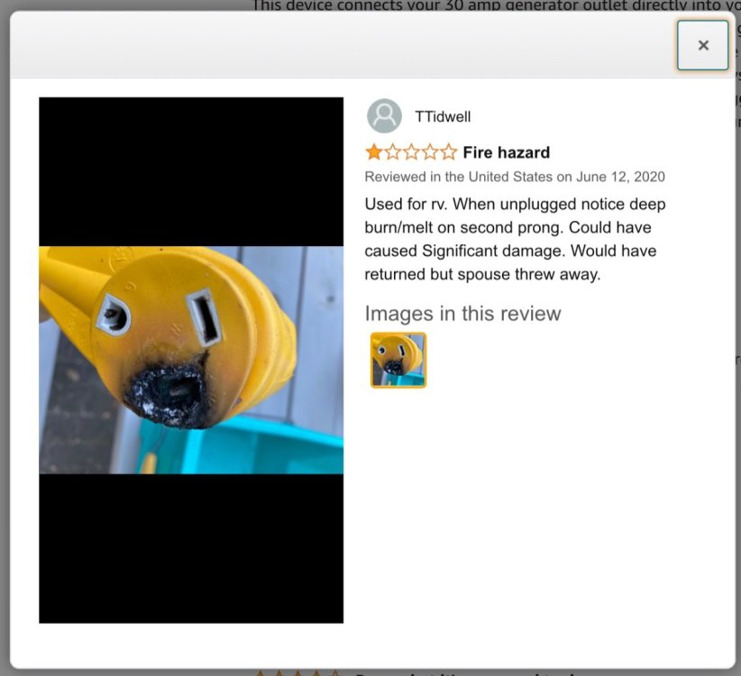

John E Davies Posted June 8, 2022 Share Posted June 8, 2022 23 minutes ago, ChrisMI said: The link that John posted above has this Plug Adapter referenced. Another big caution about cheap power adapters and high amp circuits. They are cheap for a couple of reasons, they use smaller gauge poor quality wire (sometimes copper plated aluminum) and the pins in the socket and plug are substandard - they are undersized and weak, so they bend and you get a poor contact. Poof! Camco makes decent RV accessories and I have bought a lot of them, but I won't buy anything electrical. Look for a good marine part like Marinco, and expect to pay double or more. Kristie, you probably don’t want that to happen to your Ford inverter connection… John Davies Spokane WA 3 SOLD 07/23 "Mouse": 2017 Legacy Elite II Two Beds, Hull Number 218, See my HOW TO threads: Tow Vehicle: 2013 Land Cruiser 200, 32” LT tires, airbags, Safari snorkel, Maggiolina Grand Tour 360 Carbon RTT. Link to comment Share on other sites More sharing options...

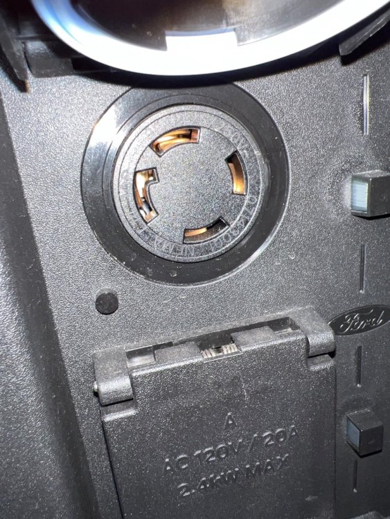

Moderators SeaDawg Posted June 8, 2022 Moderators Share Posted June 8, 2022 Hi, Kristie, and welcome to the family. Your Ollie should have come with a 30 amp rated power cord and a 30 to 20 adaptor for the plug. You could plug into the 120v/20a outlet below the 240v in your first picture. You should be able to run your a/c and some lights from that, though not the microwave or a hair dryer at the same time as the a/c. I was able to run my 13.5 dometic dinosaur a/c (no soft start) on my home outlet in that way, and we do that to plug into our little Honda generator for charging our battery, as well. Congratulations on finding your Oliver! Happy camping. 1 2008 Ram 1500 4 × 4 2008 Oliver Elite, Hull #12 Florida and Western North Carolina, or wherever the truck goes.... 400 watts solar. DC compressor fridge. No inverter. 2 x 105 ah agm batteries . Life is good. Link to comment Share on other sites More sharing options...
