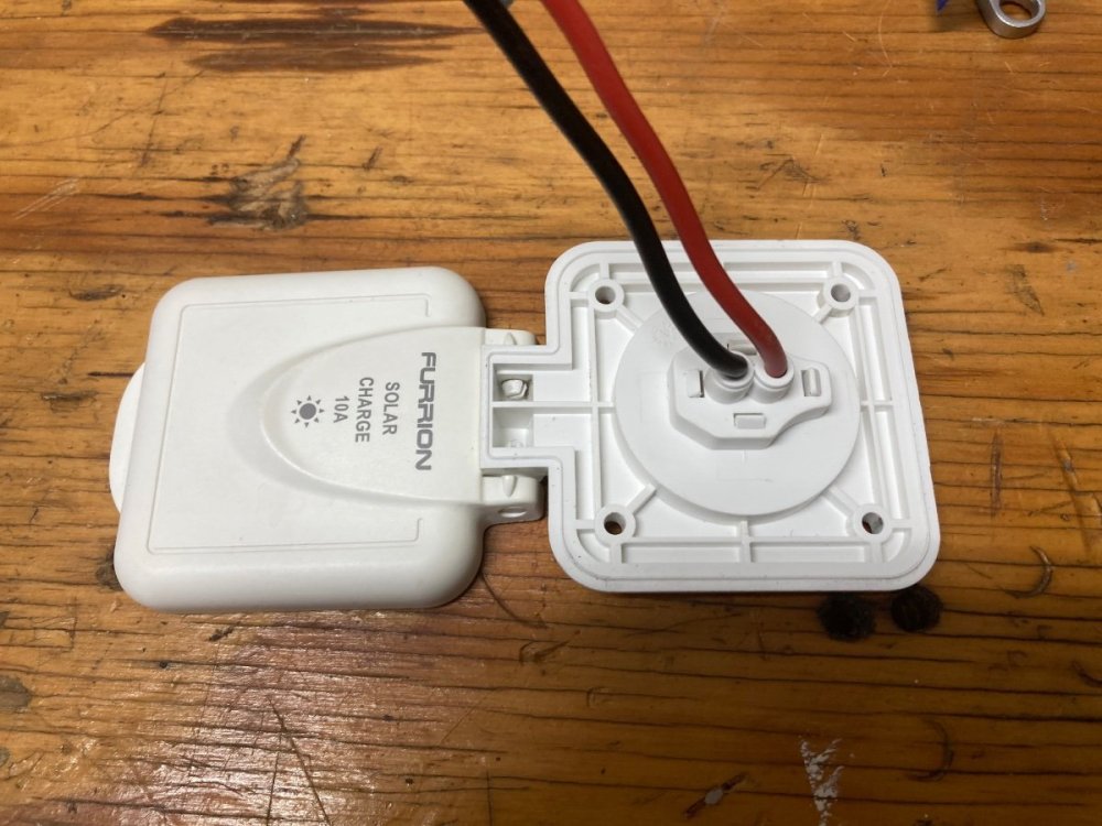

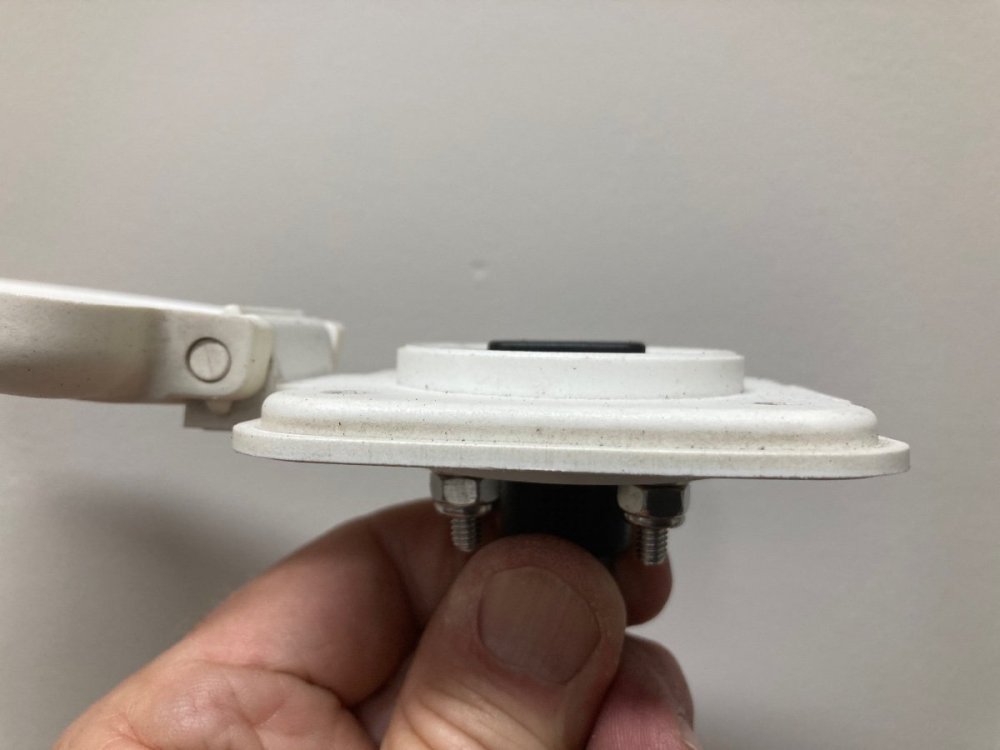

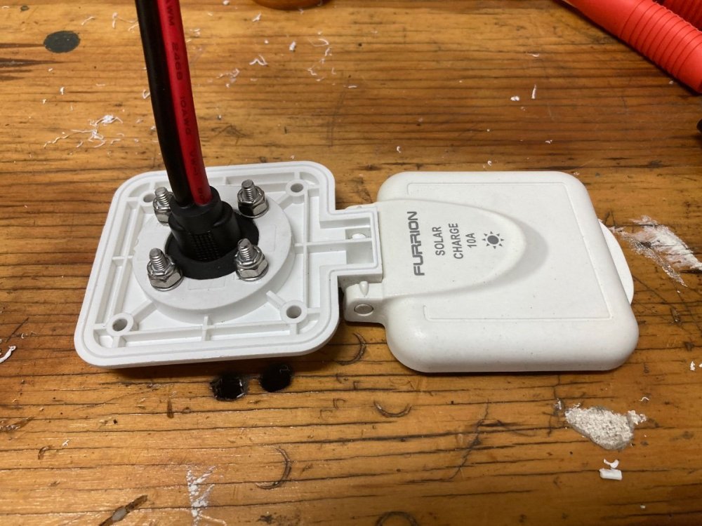

Here’s the original 10 amp Furrion solar port.
A9E2733C-ACDB-43E8-AE46-3D3C5A941405.thumb.jpeg.d14b1019347d33b297d382f5be2740a2.jpegB52D3C9E-76D8-47E5-BC54-F1A70AADFE79.thumb.jpeg.e827ca2c74cff2d3af35828e98a38f95.jpeg

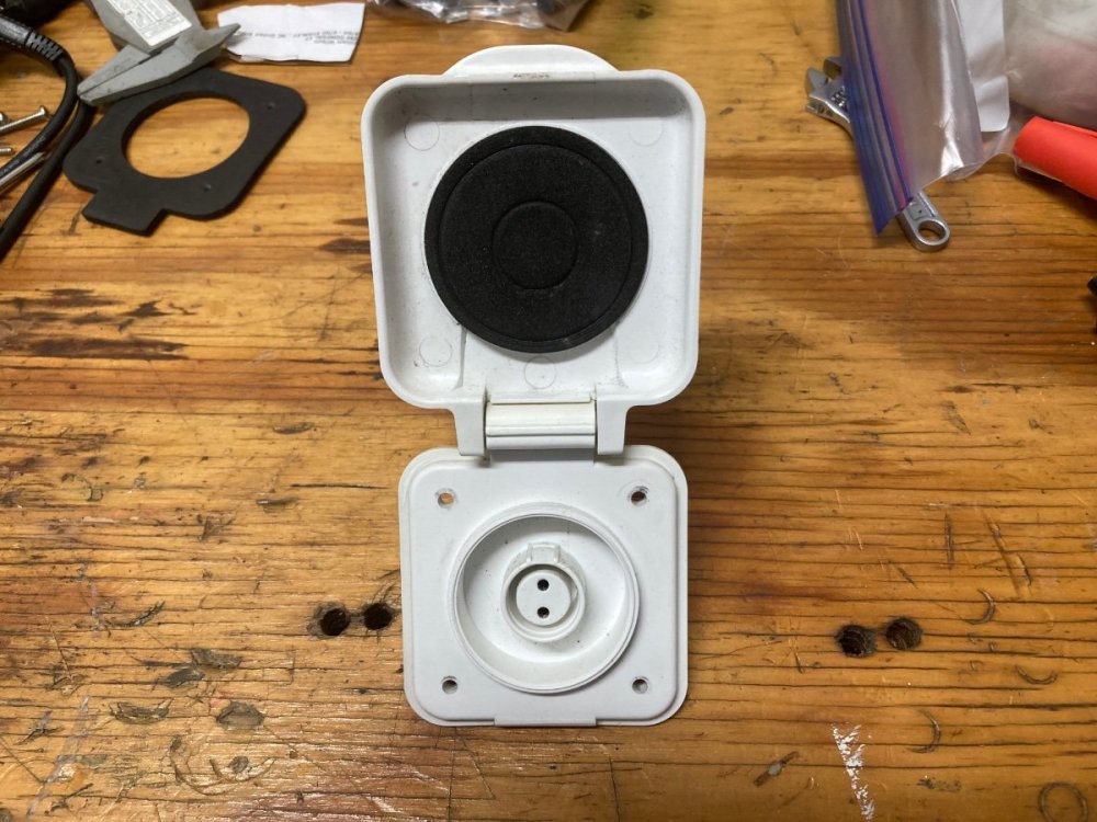

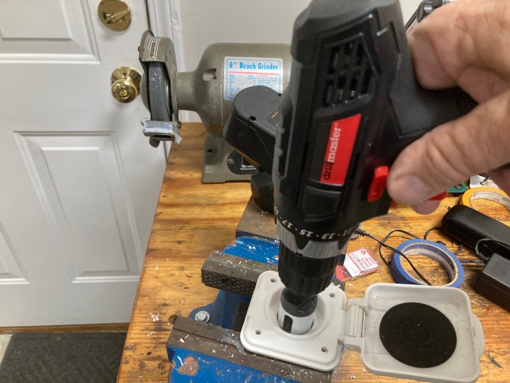

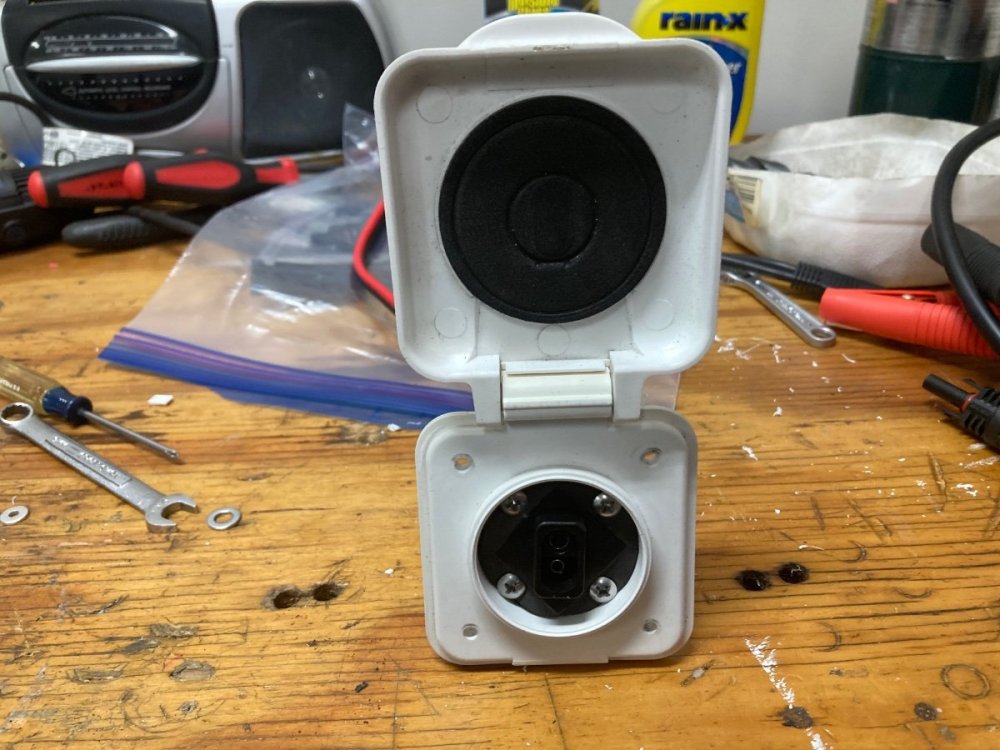

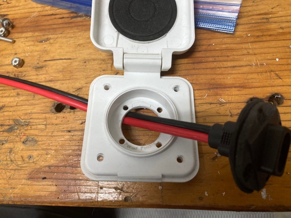

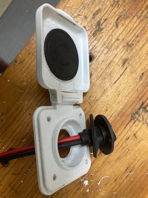

Purchased a 20 amp Zamp solar port and modified it to fit the Furrion solar port.
Used a belt sander to reduce the outside diameter of the Zamp port down to 1.70”. Made a rubber gasket to seal between the Zamp port and Furrion housing. Drilled four holes through the rubber gasket, and Furrion housing using the Zamp port’s existing holes as a template. Used a 1 1/8” or 29mm hole saw to drill through the Furrion housing so the Zamp port would fit.
6AEA008C-CE49-4F01-86A6-7C93B2873C35.thumb.jpeg.5f786b896c157a33ea0b63d57dcd9387.jpeg58F2EB0B-11E1-49C1-BA58-F83E5F6F8D16.thumb.jpeg.13fbf71097f4320f59c8c91228ff6990.jpeg
Wanted the original Furrion lid gasket to seal the Zamp port properly:
Finished solar port:
