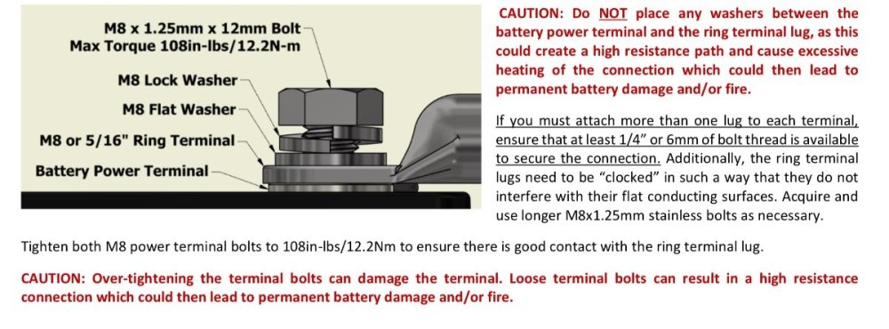

Stevon Posted September 21, 2022 Posted September 21, 2022 I have the same three batteries. One always seemed to never discharge or charge as fast as the other two. A physical check of my battery bank revealed the + connection on the offending battery was loose. I couldn’t tell by trying to wiggle it as the short cables are too stiff. But a wrench quickly found the issue. Since it’s been snugged up they all stay very close on charge/ discharge rates. 3 2021 Oliver Legacy Elite II Hull #845
DaveAndBecky_NorthernMI Posted September 21, 2022 Posted September 21, 2022 On 9/16/2022 at 12:25 PM, Rivernerd said: While I laud Lithionics customer service response, I presume there is no way for a user to recalibrate the BMS, even with the app? Lithionics did tell me their Tech support could walk me through the recalibration process if needed again. 1 2 2022 Oliver Elite II Hull#1047 "Saunter" Solar Pro 390 aH Lithionics 2022 Ram 1500 5.7L Hemi
DaveAndBecky_NorthernMI Posted September 21, 2022 Posted September 21, 2022 1 hour ago, Stevon said: I have the same three batteries. One always seemed to never discharge or charge as fast as the other two. A physical check of my battery bank revealed the + connection on the offending battery was loose. I couldn’t tell by trying to wiggle it as the short cables are too stiff. But a wrench quickly found the issue. Since it’s been snugged up they all stay very close on charge/ discharge rates. What are recommended torque values for battery connections? I know I have seen a list on the forum for all torque values but could not find that thread in search. 2022 Oliver Elite II Hull#1047 "Saunter" Solar Pro 390 aH Lithionics 2022 Ram 1500 5.7L Hemi
BBL Posted September 21, 2022 Posted September 21, 2022 4 hours ago, DaveAndBecky_NorthernMI said: What are recommended torque values for battery connections? I know I have seen a list on the forum for all torque values but could not find that thread in search. From the Lithionics Manual… Brian PS - it should be on the battery label as well. 2
