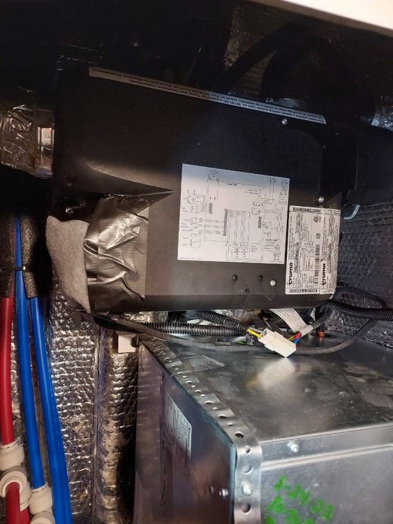

After reviewing some posts asking why RV furnaces have no air filters, I decided to add one to our Truma Varioheat furnace.  Home furnaces have filters to protect the motors and fans from dust accumulation, why not RV furnaces?
My filter consists of a piece of filter fabric cut to size and attached to the front of the cold air intake with "No Residue" duct tape.
See photo below.

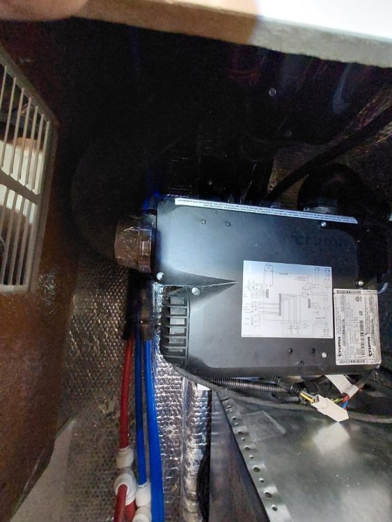

Here is what the furnace looked like before installation of the filter:
1378025593_VarioheatFurnaceAsInstalledbyOliver.thumb.jpg.07c58e38c9392ce6c8973a10e7287ff9.jpg
I tested the furnace after installation, and noted no difference in its operation.  I will be interested to see, over time, if the filter collects a noticeable amount of dust.  I would rather have the dust collect in the filter than on the fan and motor!
The filter fabric is available here for seven bucks:
https://smile.amazon.com/dp/B077SP23FP?ref=ppx_yo2ov_dt_b_product_details&th=1
The 4'x1' piece I received includes enough for many years of filter changes.
I welcome any comments, in favor or against, the use of such a filter.

This is an update based on data gathered over the past 6 days using the Varioheat furnace during cool weather on the Oregon Coast.  We kept getting an error code on the CP Plus wall control unit advising that either the supply ducts or the return air vents were obstructed.  It would shut down, then re-ignite.  We ensured there was nothing under the bed on our standard floor plan Hull #1291, but the error codes persisted.  So, I removed the air filter I installed as described in my original post on this thread.  VOILA!  No more error messages.
I have concluded that the Varioheat furnace is calibrated to function without a filter, and that my addition of a filter set off an airflow sensor causing it to shut down.  So, my experiment with a homemade add-on filter created an unintended failure.
I plan to leave the filter off of my Varioheat.  I recommend you do the same.

I asked Oliver why it didn't have a filter.  They didn't have an answer, and I'm still confused about this.  Your filter idea is exactly what I was thinking about doing, and even though you encountered the error message, I am assuming it is because you needed to INCREASE the filter surface area to improve airflow.  My idea included using a HEPA filter since I have horrible dust and mold allergies.  With your test, I will have to create a larger box to allow for more airflow.  Hopefully, this will be enough to not cause the error.
The CFM through the furnace is not really that much.  A fan powered induction box could be tied into the Truma fan intake so as to "Pressurize" the inlet of the Truma thereby avoiding the low pressure warning.
