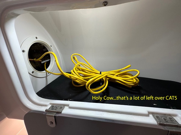

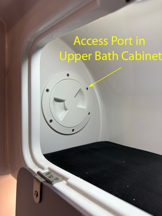

In 2019 - Hull 505 - The Cell Booster and WIFI power switches are mounted to the right of the upper storage bin above the front dinette seat.  There's an access port in the left side of the upper bathroom storage cabinet (above toilet with the mirrored front.)
Inside that access port is where the cables run down from the WIFI Booster on the Drivers Side FRONT of the trailer.
The WIFI Router is mounted on the wall inside the upper cabinet on the right end (against that cabinet wall). The actual external WIFI Booster/Antenna's are mounted outside on the top of trailer just above bathroom cabinet.
The Cell booster is at the far end in the upper cabinet mounted against the pantry wall.  There's an access port inside the pantry wall.
The outside cell antenna is a magnetic mount on a plate on the roof.  The cable runs through that plate with lot's of sealant around it. The cable snakes it's way between the two hulls and eventually ends up in the pantry access area.
What I've learned is new "wifi boosters" use a different kind of cable than the ones put in older vintage trailers. (Sigh) So even if the cable is inside the trailer it might not be the correct cable for todays boosters.
Hope this helps a bit.
