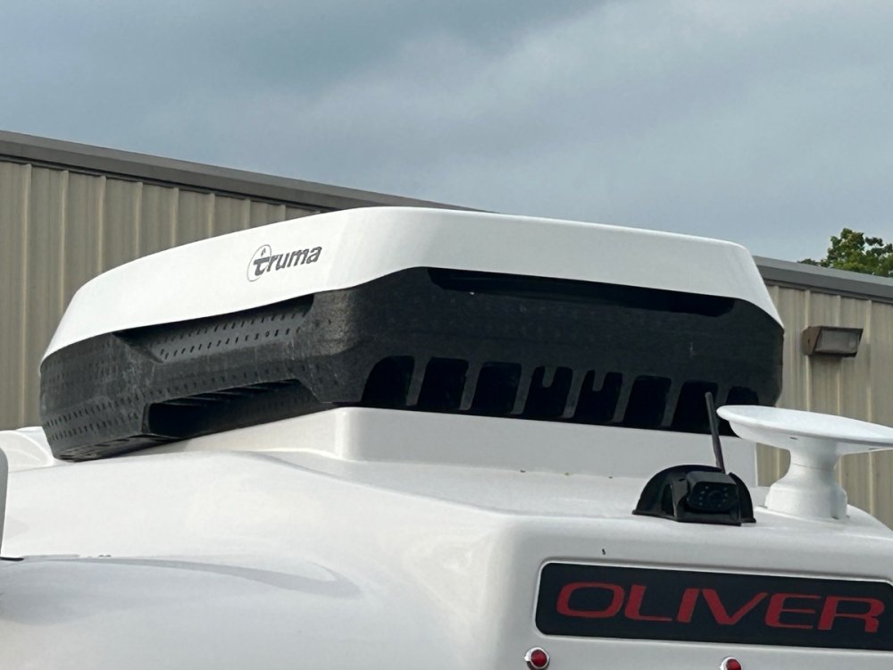

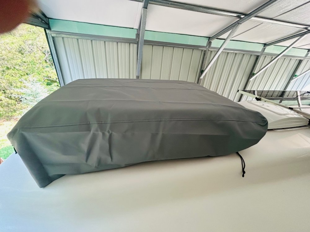

Yes, I guess there are trade offs for sure. We are really enjoying the Truma and how quickly it will cool our Ollie down. I ordered a custom made cover for the Truma as I could not find one anywhere on line. It’s due in mid week. I will post up a pic for fitment when it arrives.
The design of the rear vents on the Truma are 💯 bird nest condo move in friendly. 😄 Here in Western NC we need to keep it covered when ever we are not traveling.
Patriot🇺🇸
Oliver’s replacing our Dometic A/C with the Truma this week 🤗. Thanks for the info about how inviting the Truma is for bird nesting. I found a lovely Carolina Wren nest in my Dometic just a few days after parking our Ollie near some trees, and decided to screen in the large intake holes. Do you think there’s any way to fit a screen on the “bird nesting” holes on the Truma?
Ah those industrious Carolina Wrens strike again! 😄
Congrats on your new Truma, you’re gonna love it. I gave some thought about screening the holes. The Truma base is molded or formed with a robust tough black styrofoam material likely for weight reduction. Not saying you can’t mod a screen as anything is possible. There are multiple air intakes and it would be an ambitious undertaking to screen all areas in my observation.
With the Truma under a 2 year factory warranty I opted not to modify the air intake holes with any mesh screening that could possibly reduce air intake and potentially void the warranty. The custom cover is easy on and easy off.
