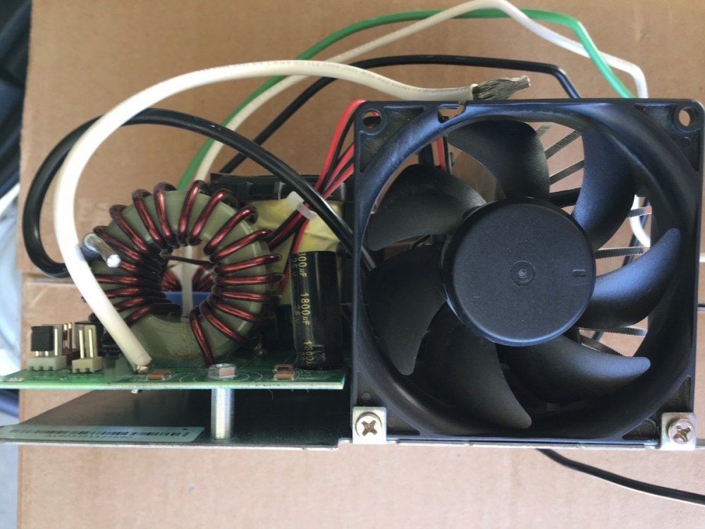

John E Davies Posted May 7 Share Posted May 7 See this thread. Since yours is an older hull, you should strongly consider just replacing the entire charger (converter) with a new one that is capable of charging lithium batteries. https://olivertraveltrailers.com/forums/topic/4812-how-to-progressive-dynamics-pd4045-lithium-upgrade/ Even if you don’t add lithiums, the next owner will appreciate the converter upgrade. This shows the fan in question (not my pic). John Davies Spokane WA 1 1 "Mouse": 2017 Legacy Elite II NARV (Not An RV) Two Beds, Hull Number 218, See my HOW TO threads: https://olivertraveltrailers.com/topic/john-e-davies-how-to-threads-and-tech-articles-links/ Tow Vehicle: 2013 Land Cruiser 200, 33" LT tires, airbags, Safari snorkel. Link to comment Share on other sites More sharing options...
