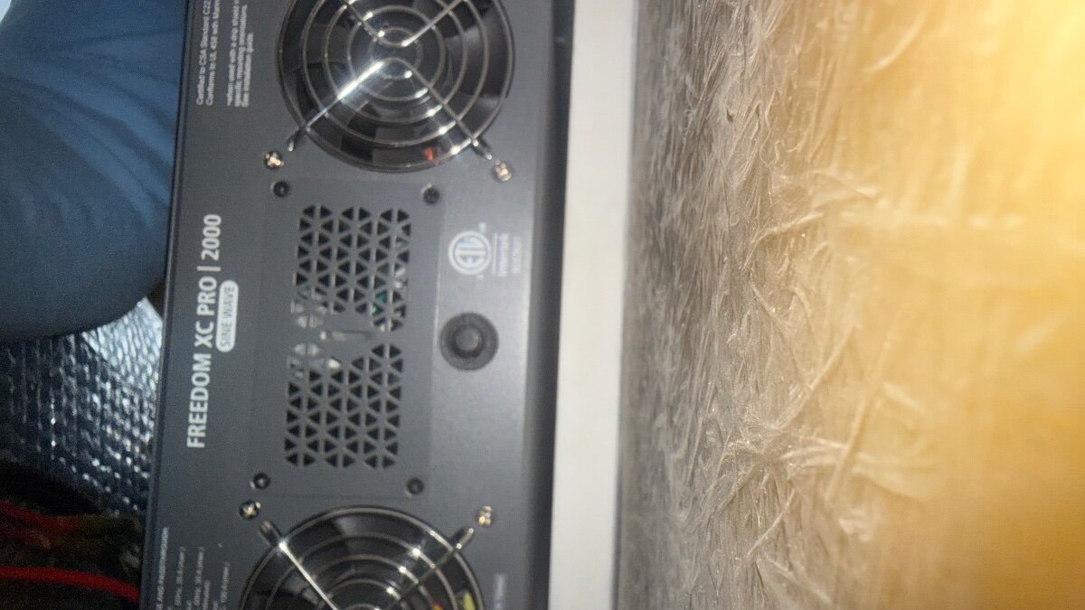

Guest Posted September 27, 2025 Posted September 27, 2025 If you can’t turn the inverter on using the remote panel, try using the controls directly on the inverter. Lots of information available here - https://support.olivertraveltrailers.com/portal/en/kb/articles/xantrex-inverters

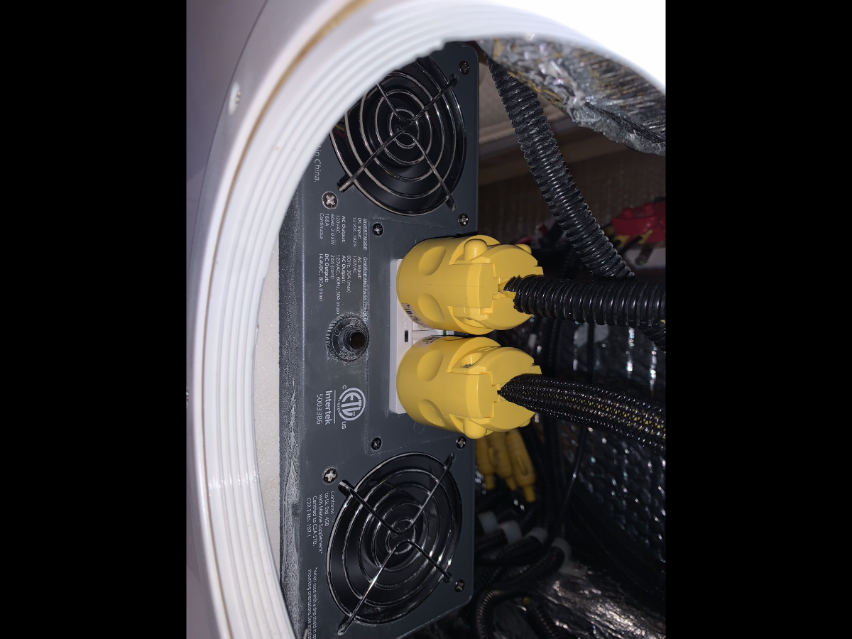

Ronbrink Posted September 28, 2025 Posted September 28, 2025 (edited) Check the GFCI on the end of the inverter where the microwave is plugged in. These trip at times and need to be reset by pushing in the breaker button located between the two receptacle outlets if you are not familiar with these. There should be a round access port near the floor labeled GFCI. Edited September 28, 2025 by Ronbrink 1 Ron and Brooxie | Clear Lake (Houston), Texas 2020 OLEll, Twin, 579: No installed solar, dual 30# propane tanks w/GasStop safety devices, Renogy 40A DC-DC charger, 460Ah LFP battery bank/Victron SmartShunt, auxiliary Cerbo-S GX/Victron 30A Blue Smart IP22 Charger combo, interior mounted Hughes Autoformer, twin independent sliding Lagun mount tables, extended dinette table and pantry landing, tongue-mounted hoist, Beech Lane refrigerator Ventilation/Evaporate Coil fans, metal valve stems with TST cap sensors and signal repeater, Waste Master sewer hose management system, Dreiha Atmos 4.4 A/C upgrade/Ceilo Breez Max thermostat, FlagpoleBuddy Starlink Mini suction mount kit. 2019 GMC Savana 2500 Cargo Work Van: Explorer Limited SE, Low-Top 7 Passenger van conversion, 6.0L V8 Vortec, 6-Speed Automatic, RWD; Air-Lift LoadLifter air suspension/WirelessAir compressor; Bilstein B6 4600 Series shocks; metal valve stems for TST tire pressure monitoring system; Buyers Products cargo containment boxes/DC Cargo securement system; rear bumper DC-DC Anderson power cable outlet; 100Ah 12V portable power station/Dometic CFX 75L Dual Zone cooler; front 2” receiver hitch/QuikrStuff Mach2 double bike rack; Mechman 320A high output alternator; Starlink Mini/Veritas Vans magnetic mount.

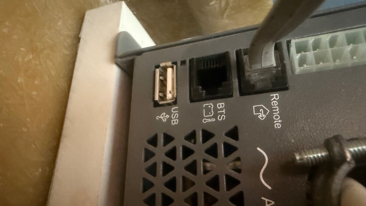

Skipster Posted September 28, 2025 Posted September 28, 2025 Took off breaker panel to have access to remote plug. Unplugged and put back in a few times when I turn inverter breaker off and then back on I hear a beep and another noise but inverter still not switching on I do not see where microwave would plug in We do not have a microwave and access is through the seat or by taking breaker box off skip and cyd nielsen hull #822 Elite tow vehicle 2017 jeep trailhawk v6
Skipster Posted September 28, 2025 Posted September 28, 2025 That little button on the end of the inverter is not popped out and does nothing when I push on it skip and cyd nielsen hull #822 Elite tow vehicle 2017 jeep trailhawk v6

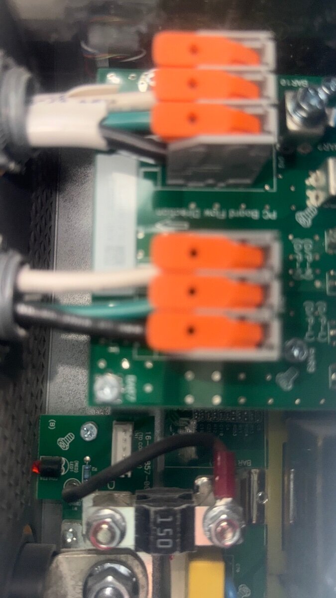

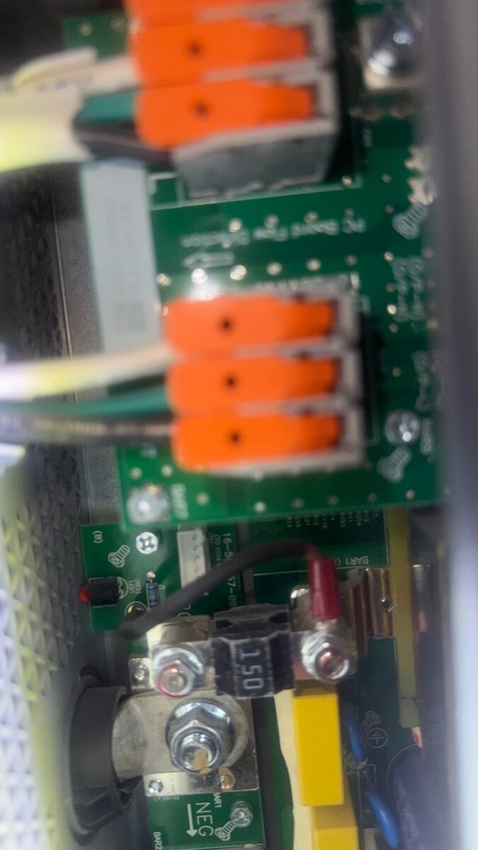

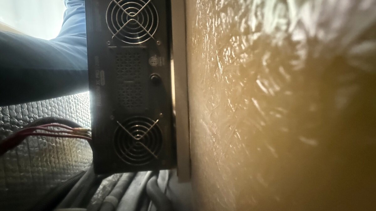

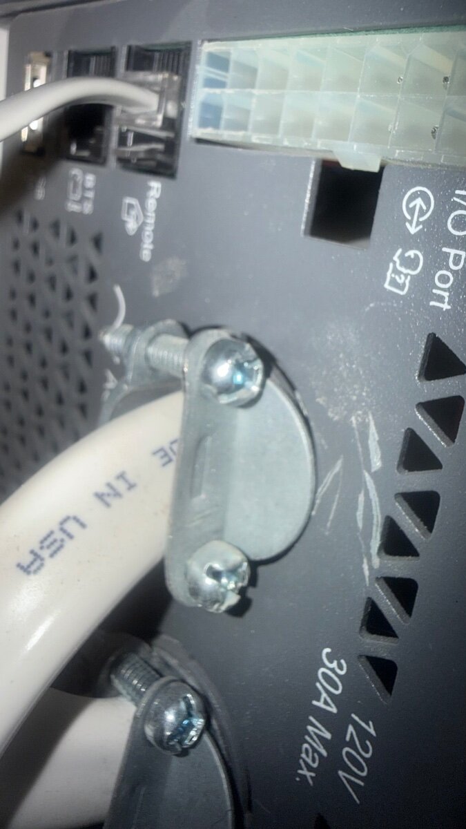

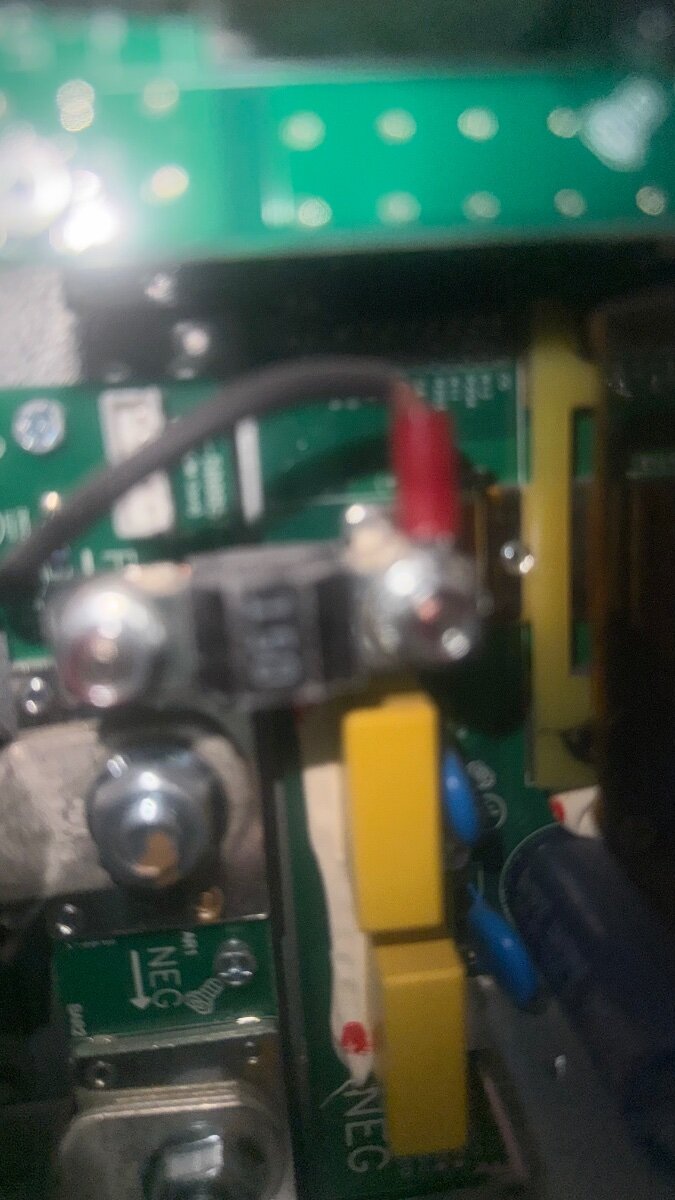

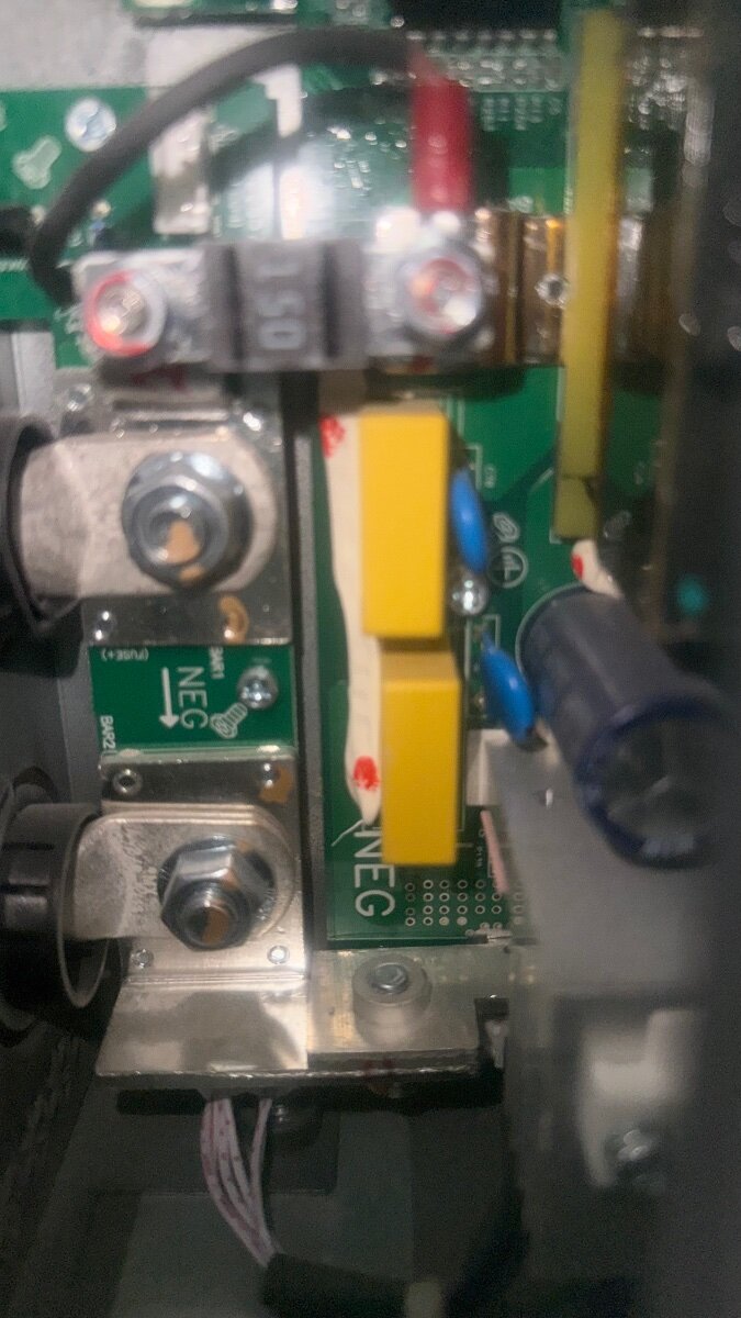

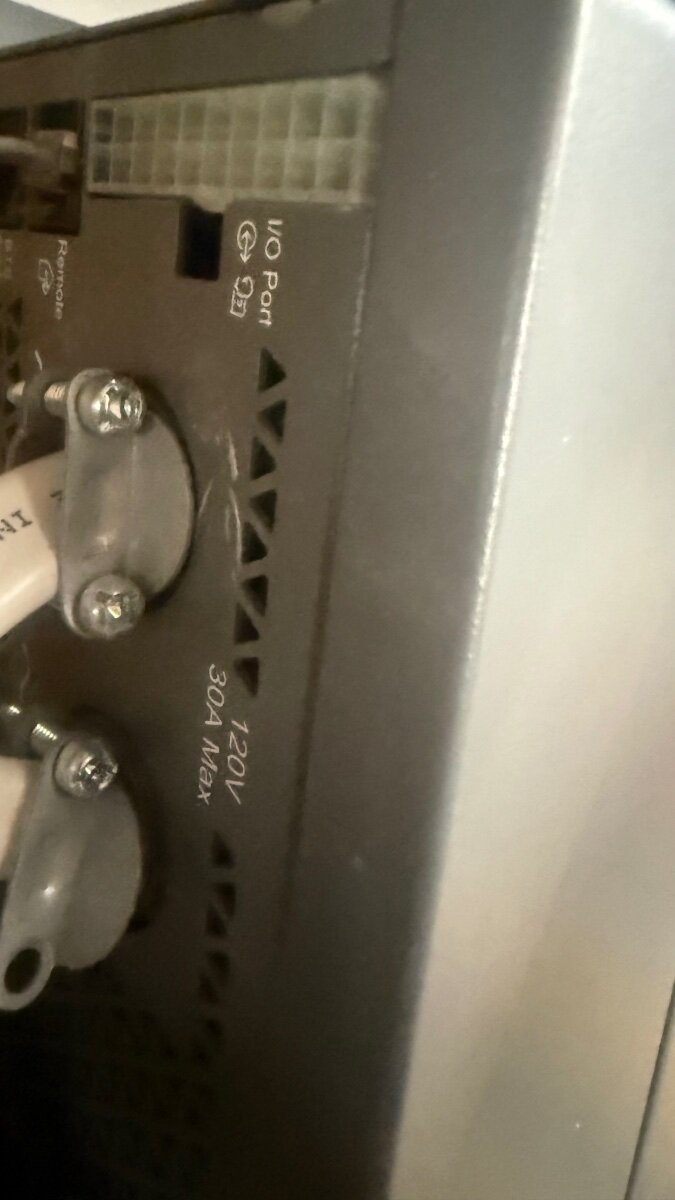

Skipster Posted September 28, 2025 Posted September 28, 2025 Took cover off and nothing seems loose. Couple pics with cover off skip and cyd nielsen hull #822 Elite tow vehicle 2017 jeep trailhawk v6
Skipster Posted September 29, 2025 Posted September 29, 2025 Took cover off and nothing seems loose. Couple pics with cover off Will check for power with a meter tomorrow skip and cyd nielsen hull #822 Elite tow vehicle 2017 jeep trailhawk v6
jd1923 Posted September 29, 2025 Posted September 29, 2025 My replies are and will be added to the other thread, and there are more relevant pics there... I was hoping this would have been corrected... 1 1 Chris & John in Prescott, AZ | 2016 EII #113 | '01 Ram 2500 Cummins!
