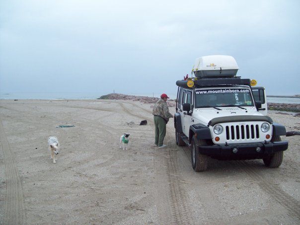

Moderators mountainborn Posted August 31, 2014 Moderators Posted August 31, 2014 In this photo we are 65 miles down the raw beach drive from the Malakeet campground at the Mansfield cut on the Padre Island National Sea Shore. It is another 65 miles of raw beach driving to get back to camp. You might notice my buddy Dillon the drug dog looking nervously at the front tire of the jeep. When he went to it I noticed that we were having a flat. Yep, it turned into a adventure alright. So, what do you think ? Overloaded ? I would rather wake up in the middle of nowhere than in any city on earth 08' Oliver Legacy Elite HULL NUMBER 0003(sold)

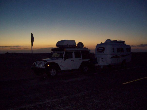

Moderators mountainborn Posted August 31, 2014 Moderators Posted August 31, 2014 Here we are at the end of the road at South Padre Island, at Dawn, after overnighting. Pretty well loaded up, isn't it ? It worked well for us, but may not be for others. I would rather wake up in the middle of nowhere than in any city on earth 08' Oliver Legacy Elite HULL NUMBER 0003(sold)
