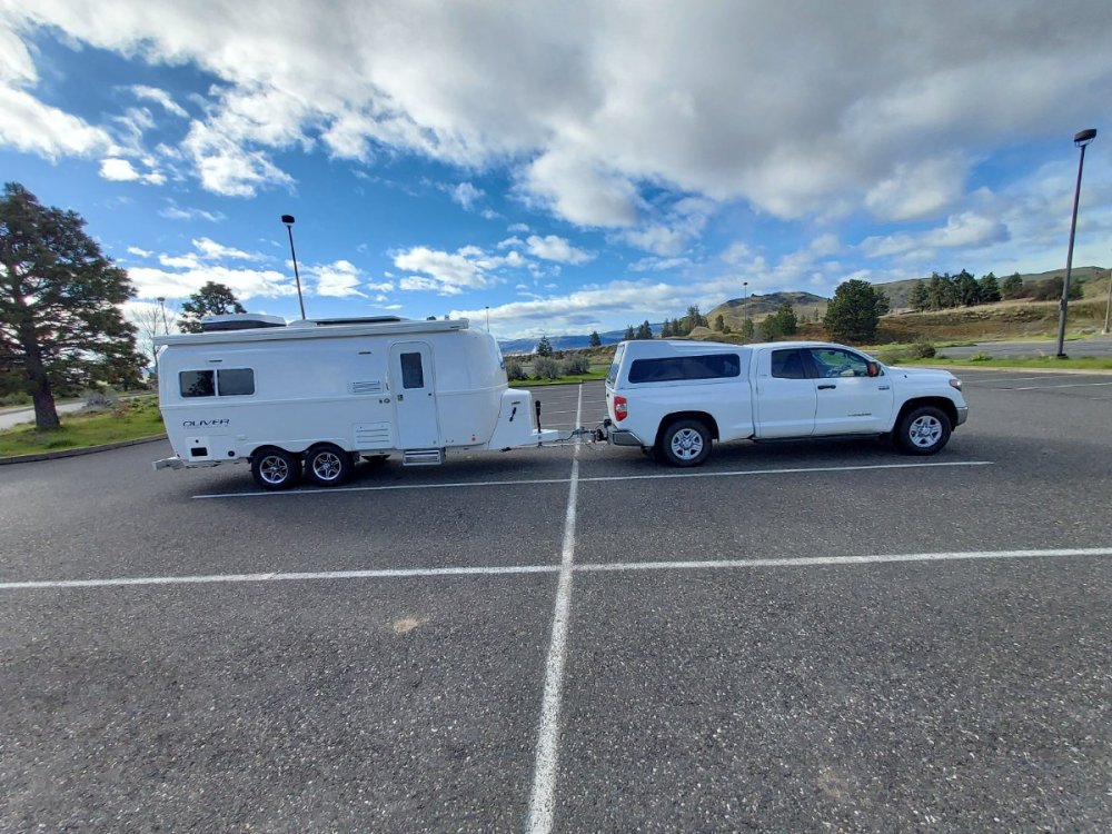

The tow vehicle for my 2022 Elite II is a 2019 Tundra, 5.7L V8 with tow package.  The top of my Andersen hitch ball sits precisely 23-1/2" from the ground, on a level concrete surface, without the trailer attached.  Of course, when the trailer is attached the truck squats a bit, which then results in a level towing position.
I am quite particular about ensuring that the trailers I tow sit level when towed.  Placing the top of the Andersen hitch ball at 23-1/2" off a level floor, with a Tundra, will result in a level towing position for an Elite II, if both the truck and trailer are properly loaded.  See photo below.

@Dave and Dana:  FYI:  We roll the same as @Rivernerd regarding attention to TV/OTT level when towing.  Our 2" Andeerson ball height is exactly 23.75" off a level surface when the TV is properly loaded.  The Bulldog is 23.25" above level surface....  Our Tundra  squats about 1.5 - 1.75" when coupled.  We've added AirLift suspension bags which help reducing "porpoising" while towing, extend suspension life, and can fine-tune level conditions, if necessary.  We're running them with approximately 23psi.  Hope this helps out.
