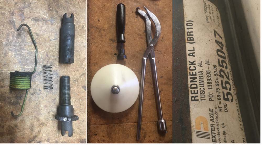

The two axles both had identical labels, see label/part number, and there was another label "Nev-R-Adjust" on both. Love the REDNECK AL label - LOL! My front axle must be the older version.
The only differences are as follows; There is a different top post which does not need the oblong assembly plate, there are two springs (easier to remount with drum brake tools) vs the one main cross spring. The self-adjusters are identical with one exception. The second one has the spring (pictured). I don't see any purpose for the spring, except to hold the adjuster nicely to the shoes during assembly. The spring is extremely light duty and can't do much, or is this the reason why some shoes "over-tighten?" Hmm, probably not. I've done brake jobs on a dozen 50s-60s-70s cars with drum brakes. They all had the two top shoe springs with oblong plate, never a large cross spring, and I don't ever remember having a spring in the adjuster!

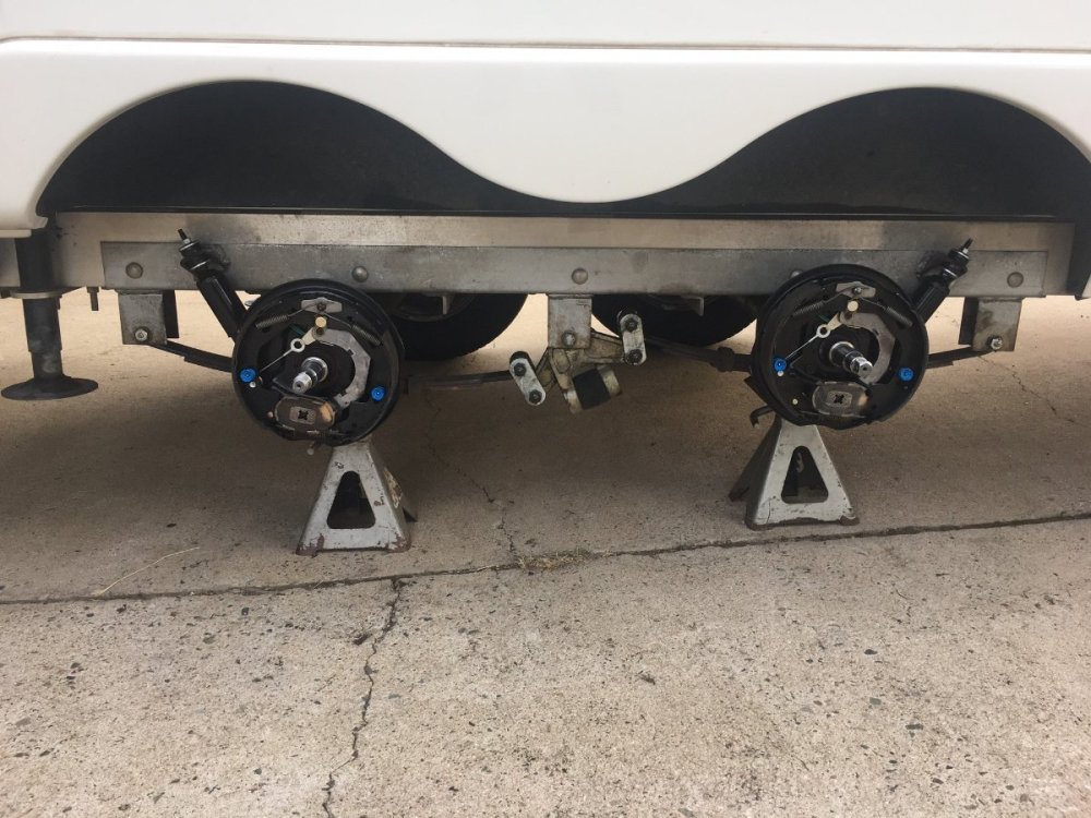

Said I needed a day off and then took 4-5! Worked a couple hours each of the last few on this job. One day, jacked up the curb side and tore everything down. Next day cleaned the brake parts and today I ran the pressure washer on the suspension, the brake backing plates and everything I could reach underneath. Been working a bit more than usual, getting in the way of my OTT work!

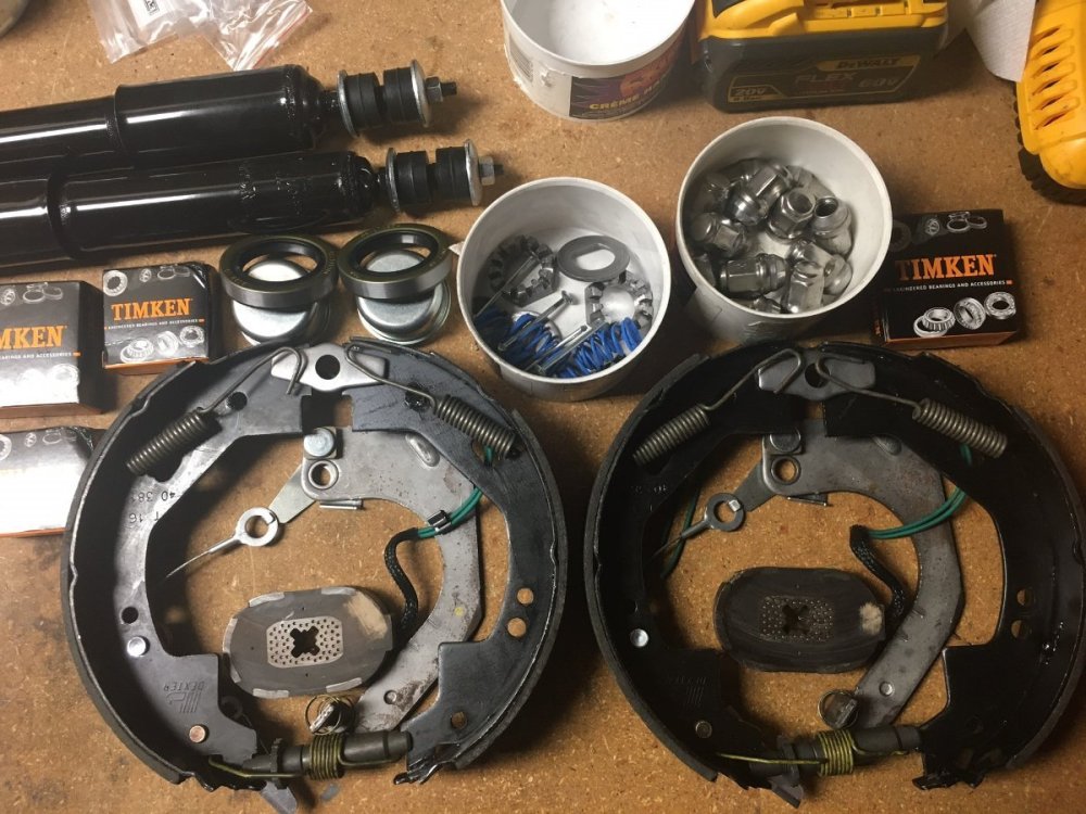

It's nice to line everything up to be ready. I need to install the races; the old ones are out. It's best to mount the shoes first with the spring-pins. Then the adjuster, the magnet and pulley line, and last the upper springs (got a nice tool to pull them).
Notice this side has two (2) like designs of the Nev-R-Adjust brakes. The ones with two small upper springs connected in an 'A' shape. My other side had the rear with the long horizontal spring, like @Ronbrink's above. What did a PO do? Smash the rear wheel and have to replace it? Or did Dexter build an axle like this, with different assemblies on each side? The one-off assembly had a thin weak spring in the adjuster. The other 3 did not and in all my life doing brakes on old cars, none of them ever had a spring in the brake shoe adjuster.
Both assemblies are equally clean. There is just more shop lighting on the left one. BTW, a little Sil-Glyde grease on the lever and spring behind the magnet helps too.

Got it back together Friday. Laying on the ground to get the adjusters close, what a pain! You have to turn the power up on your brake controller when first towing. Pulled the Oliver some on Sat and Sun. Used the controller actuator to get them to kick in often and adjust. Got the brakes nice now. I can't understand wanting manual adjust shoes, not me. And the wheels had quite a bit of up-n-down play before. Not anymore and it's done finally.

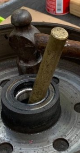

The CRC degreaser and brake cleaners I used worked great along with a parts cleaning brush and drip pan.
And the magical brass punch/race remover!  I have not seen one of those in decades.  Sweet.  Who did you order it from?
It was an Amazon purchase, however………
