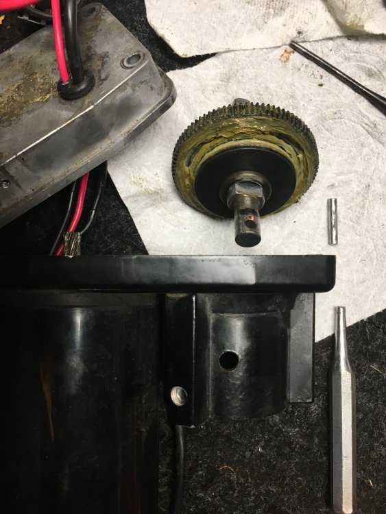

jd1923 Posted October 21, 2023 Share Posted October 21, 2023 This OTT Service video is just about useless! If that's all you're going to do, don't bother, they would be better off sealed and left alone. @John E Davies wrote a how-to video. Then check page 2 where I added my update. I'm believe I'm the only one who worked the complete service, since where you really need new grease is under the gears and there is another step in removing them (see pic). What it looks like by merely removing the cover is insufficient, as you would not even see the worn grease underneath. Check out this link and when you're done, watch the service video again for grins. 🤣 2 Chris & John in Prescott, AZ | 2016 EII #113 | '01 Ram 2500 Cummins! Link to comment Share on other sites More sharing options...
