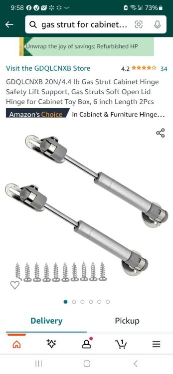

SNY SD UP Posted December 5, 2023 Posted December 5, 2023 (edited) Me again. This may or may not work, but it will probably generate some additional topic traffic. First concern, he is going into a 'wood' door and 'we' are going into plastic. Next concern, would be what do you anchor the lower side of the piston to. Obviously the floor of the cabinet, but how solid is that to hold screws under tension. I can see the top bracket being attached to the same type of round threaded metal disk on the outside of the cabinet that the existing hinges attach to. Finally, would the working location of the piston or other 'spring loaded' scissors hinge' make it difficult to get large items in & out. Edited December 5, 2023 by SNY SD UP every now and then I hit submit, before it is ready for primetime... Maggie & Bryan | Arnegard, ND | 2020 LE II "Twins" Hull #665 | 2021 RAM 2500 6.4L HEMI Gasser 4dr 6.5' bed
SNY SD UP Posted December 5, 2023 Posted December 5, 2023 On 12/3/2023 at 8:06 AM, Peggie said: The Ceiling is curved where a latch might be most conveniently put. The picture is what I think I will do. At least right away. The hook is at the closest flat point on the ceiling. I'll just put a small decorative chain on the door handle and continue to look at hinge options. You are correct, the curved ceiling makes it a bit more challenging. I know there are some "WOODWORKERS+OTT" owners on the forum, that may have some ideas on lift mechanism that might crossover from wood/MDF to an OTT plastic door. I am following this mod/thread, as I have thought of this for some time with regards to the attic cabinet door, so when open, it does not interfere with TV viewing. I want to be able to 'gently' lift & close, preferably auto-magically, but I guess manually would be the second choice. It might be as simple as using some double sided adhesive tape on "something like these" hooks to hold them in place, Clear (maybe there is a white) but functional. https://www.zoro.com/idesign-suction-hook-plastic-hook-clear-base-16600/i/G508348816/?utm_source=google&utm_medium=surfaces&utm_campaign=shopping feed&utm_content=free google shopping clicks&campaignid=19633513665&productid=G508348816&v=&gad_source=1&gclid=Cj0KCQiAsburBhCIARIsAExmsu77ScC7S6JEJPHqGA9qOdBxkgBzQvUXO3Gk3TQJsnrrGLxaH-wxnfMaAmaXEALw_wcB&gclsrc=aw.ds The problem is "it's a hook" that you have to 'manually mate' up with the opening on the door latch. B~Out Maggie & Bryan | Arnegard, ND | 2020 LE II "Twins" Hull #665 | 2021 RAM 2500 6.4L HEMI Gasser 4dr 6.5' bed
Peggie Posted December 5, 2023 Author Posted December 5, 2023 1 hour ago, SNY SD UP said: Me again. This may or may not work, but it will probably generate some additional topic traffic. First concern, he is going into a 'wood' door and 'we' are going into plastic. Next concern, would be what do you anchor the lower side of the piston to. Obviously the floor of the cabinet, but how solid is that to hold screws under tension. I can see the top bracket being attached to the same type of round threaded metal disk on the outside of the cabinet that the existing hinges attach to. Finally, would the working location of the piston or other 'spring loaded' scissors hinge' make it difficult to get large items in & out. I've pretty well given up on a hinge, and will attach a hook to the ceiling and a chain to the latch.
Peggie Posted December 5, 2023 Author Posted December 5, 2023 1 hour ago, SNY SD UP said: You are correct, the curved ceiling makes it a bit more challenging. I know there are some "WOODWORKERS+OTT" owners on the forum, that may have some ideas on lift mechanism that might crossover from wood/MDF to an OTT plastic door. I am following this mod/thread, as I have thought of this for some time with regards to the attic cabinet door, so when open, it does not interfere with TV viewing. I want to be able to 'gently' lift & close, preferably auto-magically, but I guess manually would be the second choice. It might be as simple as using some double sided adhesive tape on "something like these" hooks to hold them in place, Clear (maybe there is a white) but functional. https://www.zoro.com/idesign-suction-hook-plastic-hook-clear-base-16600/i/G508348816/?utm_source=google&utm_medium=surfaces&utm_campaign=shopping feed&utm_content=free google shopping clicks&campaignid=19633513665&productid=G508348816&v=&gad_source=1&gclid=Cj0KCQiAsburBhCIARIsAExmsu77ScC7S6JEJPHqGA9qOdBxkgBzQvUXO3Gk3TQJsnrrGLxaH-wxnfMaAmaXEALw_wcB&gclsrc=aw.ds The problem is "it's a hook" that you have to 'manually mate' up with the opening on the door latch. B~Out That hook is very much like the one I'll put on the ceiling. Except those are a nice unobtrusive clear and the ones I have on hand are silver. 1

Moderators SeaDawg Posted December 6, 2023 Moderators Posted December 6, 2023 @Peggiehttps://www.boatingmag.com/installing-gas-strut-hatch-supports/ I spent some time yesterday reviewing your photos. (It was a nice distraction while my husband was in surgery for four hours.) You already have some partitions/bulkheads that we don't have in the very early elites. You "could" attach some blocks on each side, without losing too much storage space. You have a stiffener piece of square aluminum tubing , near a possible attachment point for gas struts, and the stiffener relieves the "twist" of the lightweight plexi.. You might have to add a bit of material beyond the stiffener to attach the round end to the aluminum stiffener. Might need different, shorter screws. Most important that you weigh the door, and get an appropriate gas strut pair. Too strong, and they'll fly up. Too weak, they'll not hold position. (For example, we replaced the gas struts in our pickup bed camper a few years ago. I need both hands now to come, instead if one, as we had no way to weigh the topper. And struts are too strong.) I think you have a friend helping you with this. Get his/her opinion if they've done any cabinetry work. If not, weigh it, do the best you can, and order from Amazon with free returns, and see what you think.. 1 2008 Ram 1500 4 × 4 2008 Oliver Elite, Hull #12 Florida and Western North Carolina, or wherever the truck goes.... 400 watts solar. DC compressor fridge. No inverter. 2 x 105 ah agm batteries . Life is good.
Peggie Posted December 6, 2023 Author Posted December 6, 2023 1 hour ago, SeaDawg said: @Peggiehttps://www.boatingmag.com/installing-gas-strut-hatch-supports/ I spent some time yesterday reviewing your photos. (It was a nice distraction while my husband was in surgery for four hours.) You already have some partitions/bulkheads that we don't have in the very early elites. You "could" attach some blocks on each side, without losing too much storage space. You have a stiffener piece of square aluminum tubing , near a possible attachment point for gas struts, and the stiffener relieves the "twist" of the lightweight plexi.. You might have to add a bit of material beyond the stiffener to attach the round end to the aluminum stiffener. Might need different, shorter screws. Most important that you weigh the door, and get an appropriate gas strut pair. Too strong, and they'll fly up. Too weak, they'll not hold position. (For example, we replaced the gas struts in our pickup bed camper a few years ago. I need both hands now to come, instead if one, as we had no way to weigh the topper. And struts are too strong.) I think you have a friend helping you with this. Get his/her opinion if they've done any cabinetry work. If not, weigh it, do the best you can, and order from Amazon with free returns. I love my friend and he's been a huge help with some of my projects but knowledge and experience wise he's just a me with bigger muscles and more tools. There's an RV mechcanic that does woodworking who will be back in the park this month and I may talk to him. In the meantime, the hook willhave to do.

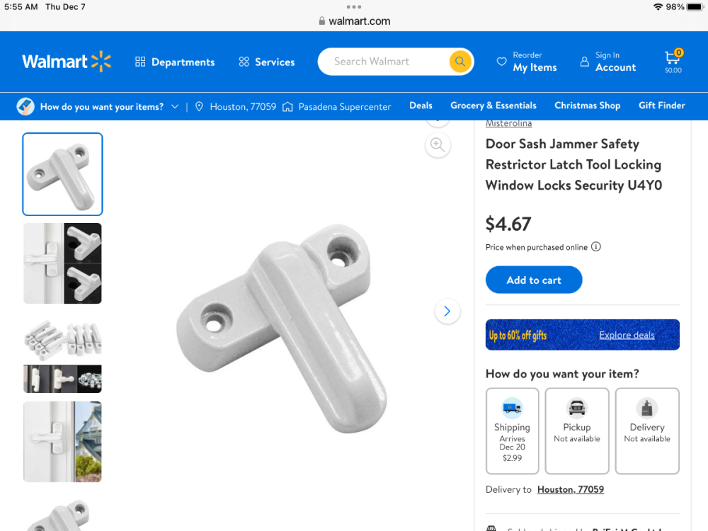

Peggie Posted December 7, 2023 Author Posted December 7, 2023 1 hour ago, SeaDawg said: The 90 degree is going to stick straight out, btw. Not a big swing up. Something to think about. In my little trailer, that would be about eye level, for short me. I had to get out the tape measure for this one. The height of the top of the door is 5'10", plenty of clearance for me (5'7 ½") but a problem for taller folks. I thought the ceiling would stop it from going much higher but when we held the door up, it had plenty of clearance. Looks like it's back to the drawing board. In the photo, my index finger is pointing to where a hook would go on the ceiling.
Ronbrink Posted December 7, 2023 Posted December 7, 2023 7 hours ago, Peggie said: In the photo, my index finger is pointing to where a hook would go on the ceiling. It appears the cupboard door is flush against the hull fiberglass; seems a simple twist lock type sash fastener would suffice. Here is one for example only, the arm would swing down and hold the door in the open position. If not flush at the top, it could be mounted on either side, in similar manner. A ‘search’ will reveal a variety of this type fastener to consider for your specific application. 1 Ron and Brooxie | Clear Lake (Houston), Texas 2020 OLEll, Twin, 579: No installed solar, dual 30# propane tanks w/GasStop safety devices, Renogy 40A DC-DC charger, 460Ah LFP battery bank/Victron SmartShunt, auxiliary Cerbo-S GX/Victron 30A Blue Smart IP22 Charger combo, interior mounted Hughes Autoformer, twin independent sliding Lagun mount tables, extended dinette table and pantry landing, tongue-mounted hoist, Beech Lane refrigerator Ventilation/Evaporate Coil fans, metal valve stems with TST cap sensors and signal repeater, Waste Master sewer hose management system, Dreiha Atmos 4.4 A/C upgrade. 2019 GMC Savana 2500 Cargo Work Van: Explorer Limited SE, Low-Top 7 Passenger van conversion, 6.0L V8 Vortec, 6-Speed Automatic, RWD; Air-Lift LoadLifter air suspension/WirelessAir compressor; Bilstein B6 4600 Series shocks; metal valve stems for TST tire pressure monitoring system; Buyers Products cargo containment boxes/DC Cargo securement system; rear bumper DC-DC Anderson power cable outlet; 100Ah 12V portable power station/Dometic CFX 75L Dual Zone Refrigerator and Freezer; front 2” receiver hitch/QuikrStuff Mach2 double bike rack; Mechman 320A high output alternator.
