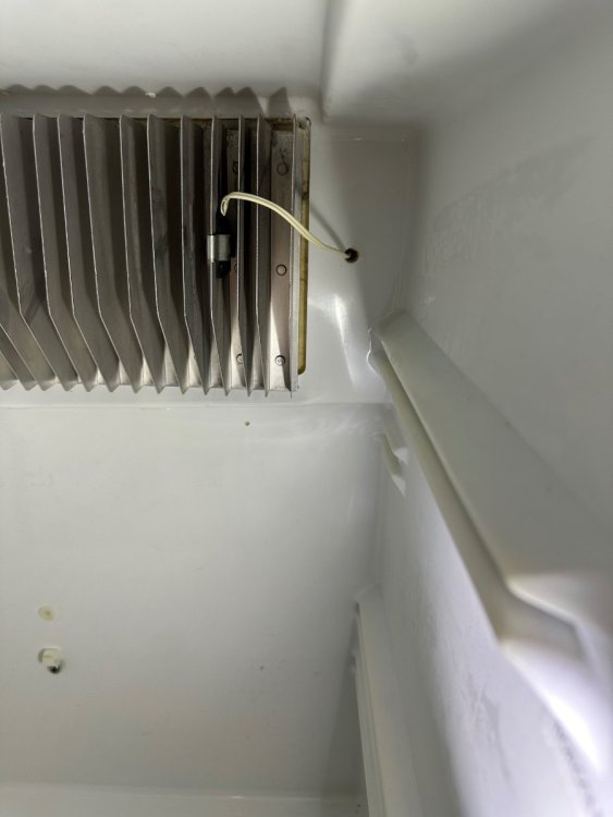

Emgmtg Posted December 11, 2023 Author Share Posted December 11, 2023 Once I "dug out" all the Styrofoam that was held in place by spray foam I was able to remove the refrigerator and replace the bad cooling unit. What I did notice while removing the bad cooling unit is that the cooling plate in the refrigerator with the fins had a small gap on one side and at the top. Upon installation of the new cooling unit the gap seems to be slightly bigger. The unit seems to be cooling great now. Are those gaps a big deal, and do they need to be sealed? Or are they sealed from behind by the cooling unit? The opening in the refrigerator behind the fins seems to be slightly too big to be completely covered by the fins as I removed the plate, and it will not entirely cover the opening. Thoughts? Hull #402 | 2018 Elite II Twin Bed | 2018 Ford F-150 Lariat 3.5L Twin Turbo Max Tow | Florida Link to comment Share on other sites More sharing options...
Moderators SeaDawg Posted December 11, 2023 Moderators Share Posted December 11, 2023 @Emgmtg, that's a curious situation. As you know, the function of the "fins" is to absorb the warm air in the fridge. Where that warm air that bypasses the fins will go, with the gap, is a good question for Norcold technical support, or Jason at Oliver. (Kind of looks like yellow insulation behind the gap in your photo. If that's so, I'm guessing it "could" collect condensation, like the fins. But, im certainlynot a fridge tech.) I don't recall ever seeing a gap like that in any of our 3ways. I think you're a brave guy, replacing your own cooling unit. Kudos to you. Our neighbor replaced the cooling unit in his older motorhome, but he used to run a small-scale appliance repair business, on the side. 3 2008 Ram 1500 4 × 4 2008 Oliver Elite, Hull #12 Florida and Western North Carolina, or wherever the truck goes.... 400 watts solar. DC compressor fridge. No inverter. 2 x 105 ah agm batteries . Life is good. Link to comment Share on other sites More sharing options...

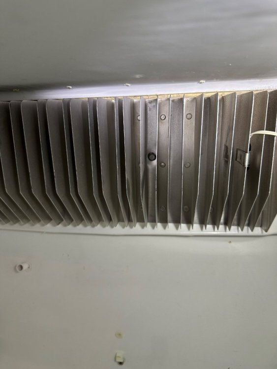

Jim and Frances Posted December 17, 2023 Share Posted December 17, 2023 @Emgmtg, I just took some no so great photos of my fins and noticed similar gaps, My guess is for easy of assembly, the cutout is a tad larger than the fins. This gap is also covered by the backing plate? Was any sealant used around the edges of the backing plate when you disassembled? Hope this helps. 1 3 SE Texas | 2021 Elite II Twin Bed # 927 "Lucy" | 2019 F250 FX4 6.7 Link to comment Share on other sites More sharing options...
Emgmtg Posted December 18, 2023 Author Share Posted December 18, 2023 I was told by the vendor that I bought the replacement cooling unit from that the gap is not that unusual and not to worry about it. It is completely sealed from behind the refrigerator when the new cooling unit is installed and sealed. The new cooling unit (backing plate) is sealed with spray foam and foil tape so that it is air tight. 1 3 Hull #402 | 2018 Elite II Twin Bed | 2018 Ford F-150 Lariat 3.5L Twin Turbo Max Tow | Florida Link to comment Share on other sites More sharing options...
