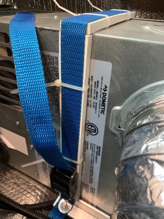

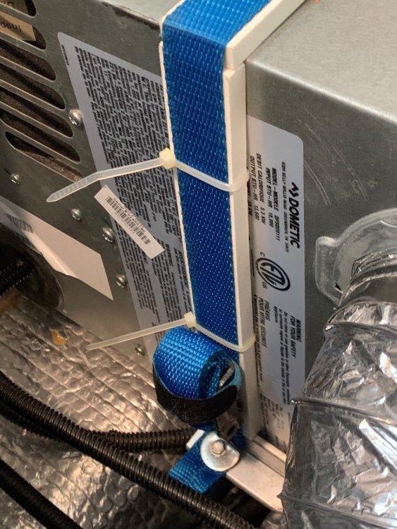

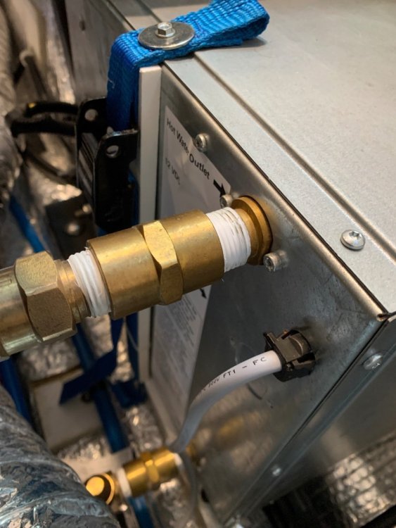

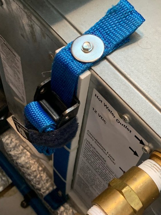

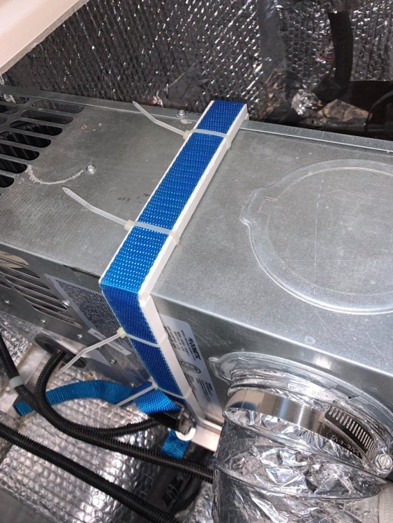

Less than two years into ownership, I made two repairs to the factory-installed metal straps used to secure the Truma water heater and the Dometic furnace. These straps were the typical HVAC metal galvanized hangers, which broke due to stress fractures likely caused by the over-inflated tires Oliver advocated a few years ago; at pickup, my 2020 OLEll Cooper tires sported 80 psi! The water heater strap broke first, repaired, then the furnace, repaired, then the water heater again. With each repair, I used a heaver gauge metal strap, to no avail. After the third failure, I decided to try some other means in hope to permanently fix this reoccurring issue. Aside from reducing the tire pressures to 55 psi, I utilized some cam-lock web straps for the fix. One year in and all good; no more worries of potential damage to the water and gas lines or electrical wires servicing these units from bouncing around while merrily driving down the road!
Lines and wires at jeopardy!
Cam-lock to tighten strap for optimum securement.
Stainless steel self-taping screws and fender washers to fasten strap ends.
Starboard strips to insulate web strap from heat and abrasion, secured with cable ties.
Excess web strap bundled and secured with a Velcro cable tie.

Nice, a lot of people just cannot fathom how much force 6 gallons of water inside a steel tank can generate when moving on rough surfaces!  Mine never failed, but I never towed with hard tires either.
What straps did you use? Regular ones? Those have some stretch which in this case is probably not a bad thing to have, but for other applications such as battery tie down straps, you don’t want to have any at all, so you should seek out mil-spec zero stretch webbing. This is excellent, with a footman loop at the bottom on each side, you can position the buckle up top where it is easy to reach and inspect. These straps will stay dead tight, they actually “twang” when you flip one with a finger, very excellent stuff!
These were some heavy-duty straps once used to tie down an ATV. I modified them for this application; the end hooks were removed, length shortened and cut ends heat treated. Although the Truma is tankless, it still has substantial weight; and restricting movement imperative, in that the lines are hard plumbed. I am very pleased with this mod.
