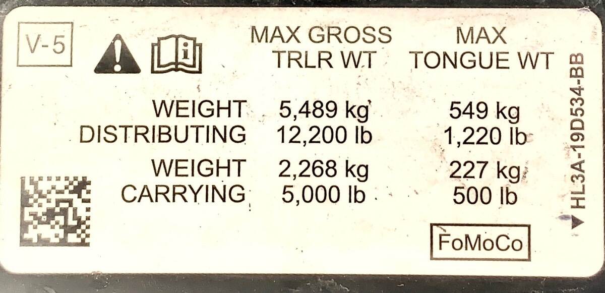

Usually the 1/2 Ton Trucks are limited by the 'dead weight" or weight carrying capability. The receiver unit on the truck you have should have a sticker like this one (from a 2018 F150) either on the actual receiver hitch or on the door frame. Notice that on this unit the max Tongue weight capacity is 500LB. (Weight carrying the case where you don't have a WDH and is essentially the dead weight from the trailer tongue down on the ball.) An Elite II tongue wt when loaded is easily above this 500lbs, and requires a weight distribution hitch to be safe and legal. In this F150 case, once a weight distribution hitch is applied, the F150 can then handle up to 1220 Lbs of direct tongue weight. The towing guides for most vehicles state the method for determining how much adjustment is needed from the WDH. Most have you: 1) Measure the unloaded truck's front wheel well height through the center of the front wheel. 2) Measure the wheel well height after loading the unit and attaching the trailer. In most cases the amount of weight distribution needed is set to bring the front end back down by at least 1/2 of the total difference in those two measured heights. Example: Unloaded measures 37" Loaded measures 41" (4' total rise). Apply enough WDH force to lower that front measurement by least 2" ....or 39" when loaded. Each manufacturers towing guide states specifics by vehicle make and model. CS

Yes.... Given a 3/4 ton truck ditch the Anderson. Have to mention for folks using a 1/2 ton that you need to read your manual very carefully. Most half tons will require a WDH if the trailer weight is over 5k lbs. Hopefully no one finds themselves on the wrong end of a lawyer trying to take their house, but if you do... you'll be glad you had the WDH installed. Quack Quack! Oh no.. wait... I got the Alcan springs. Scotty

There are numerous videos on YouTube showing how to setup the Andersen Weight Distribution hitch - like THIS ONE FROM ANDERSEN. Bill
