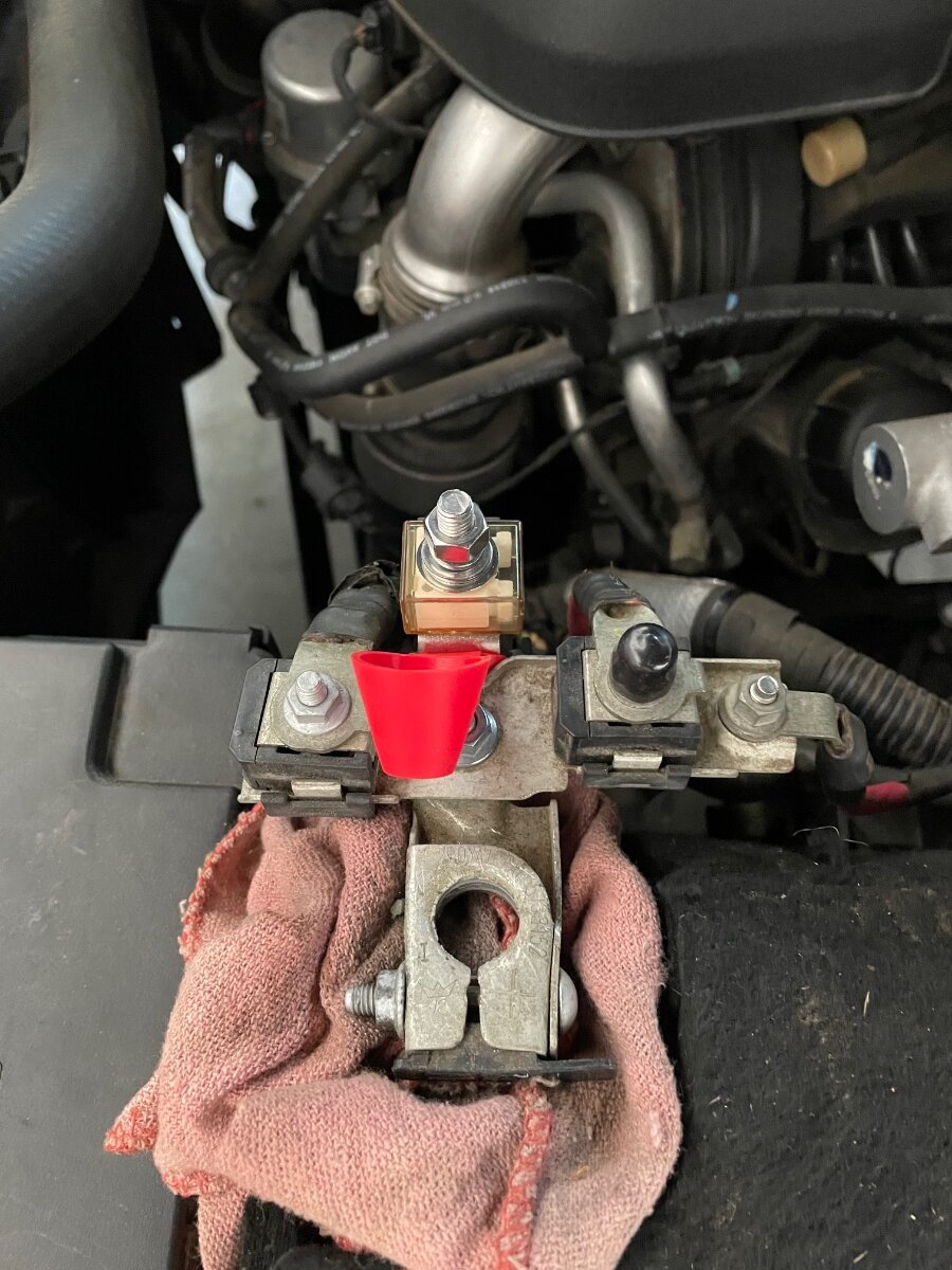

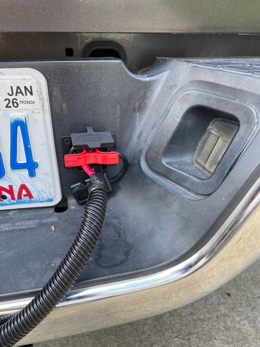

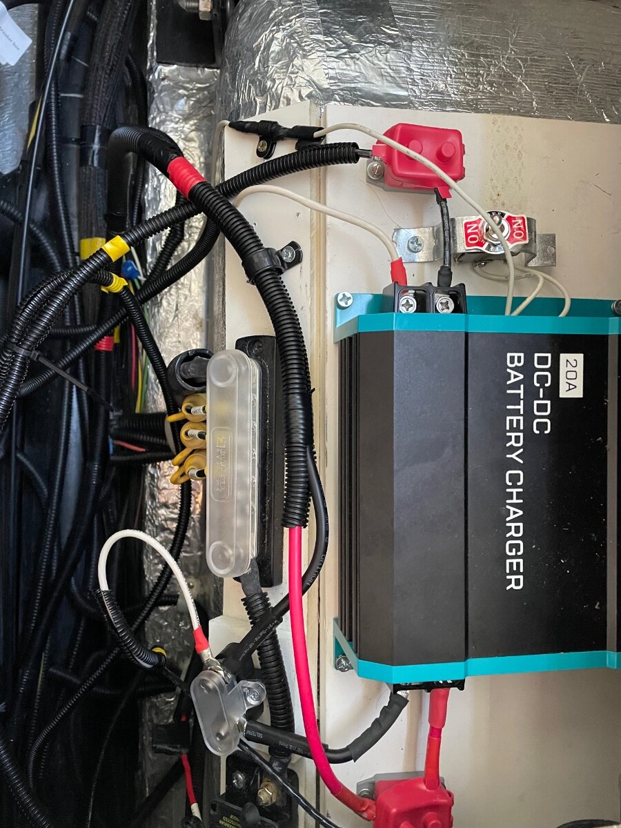

Goal: Eliminate house battery drain due to DC fridge while traveling to arrive at dry camping sites with a fully charged battery. Hybrid to refers to keeping existing charge wire when adding another charge line of heavier gage. After upgrading to a lithium battery (300 AH Epoch) I wanted to be able to negate the amp draw from our 3-way fridge (dometic RM2454) and other small loads that total about 16-17 amps. That fridge used a 100% or nearly duty cycle on DC. I purchased a Renogy 20 amp DC-DC charger. Initially I replaced the 14 awg gage wire Oliver spliced from the 12 awg pigtail power wire terminus to the charger with 10 awg. Why Oliver went to a smaller gage than the pigtail is beyond me although this was back in 2018. I also spliced a 10 gage wire to the pigtail common 10 gage that Oliver in its wisdom had also spliced to a smaller gage wire. This worked fine if I triggered the current limiting feature that reduce the charging current to half (10 amps) of the rated. When I tried to charge at 20 amps it only produced about 14 amps and resulted in a very warm pigtail plug as you might suspect. So I relented and decided to run 8awg wire through my pickup (2015 RAM 1500) and Oliver E2 - but with the intent of also using the pigtail charge wire to carry some amperage. Doing some calculations using the wire resistance of 10 and 8 awg and knowing that the voltage would be the same at the junction I planned near the charger input I figured about 2/3 of the amperage would be carried by the new 8 awg line but after installation found that it actually carried 3/4 of the amperage probably in part by neglecting the loss through the tiny 12 v wire pin in the 7-pin socket on the pickup. The ground pin has about 3x the surface area of all the other wire pins in the socket Fiberglass rods that I had were helpful in running wire and I only used a 2 or 3 foot ground leg to the chassis frame rail near the bumper so essential just ran the positive wire under the truck. I had to remove the front of the bathroom sink to pull site into the trailer. I have read that some have run wire without messing with the sink but they must be magicians! I tap into the trailer running light wire (green) to activate the charger. First results after an initial camping trip were good. When testing at idle I measure 25 amps in to get 20 out and a voltage drop of 1.1 volt from about 14.0 at the battery (I had calculated a 1 volt drop and I guess got lucky. So I wasn’t going after the big amps as my objective and figured I could run smaller gage wire in tandem with the existing pigtail to meet my needs. 30 amp fuse off positive battery terminal Andersen-type plug with t-handle above bumper entrance gland/strain relief (1/2 inch) behind propane tanks on left input on right (8awg after junction of 8 and 10 awg) and output on left (10 awg). I rummaged an old DPDT switch and used one side of it to activate the current limiting feature that should not be needed after running the 8 gage wire.

I just installed an Epoch 300 AH battery to replace our original 4-6 volt trojan agms. I have a victron shunt so I can monitor things. I did not disconnect the charge wire. So far I can only get 2.5 amps or so through the 7 pin depending on voltage difference of TV battery and smart alternator and TT. I went to the trouble of installing a normally open relay in the Oliver to isolate the batteries, and can attempt charging by turning on lights (trigger for relay). The black wire on the far right stud between the relay and the circuit breaker is the charge line from the 7 pin. Left studs are for trigger off green lights wire and ground. So, right now not much difference from just disconnecting although I need to make sure the charge and ground wires off the umbilical weren’t spliced to a smaller gage wires and test disconnecting the feedback to the smart alternator and see if it will output a constant high voltage.
I’d be very surprised if your Oliver has 10 awg wire for both charge and ground wire. Ours (2018 elite 2) has 12 awg charge and 14 awg ground. However as @John E Davies mentioned (I think in another post) he noticed a splice inside the trailer in which the wire gage was reduced. I need to check this myself in hopes of getting a tad more amperage. You may have already completed your charge modifications, but I can vouch that with the existing 7 pin and wiring, and especially with Lithium hose batteries you’ll be lucky to get any charging. I only get 2 or 3 amps. I like John’s idea of not having to mess with TV and TT wiring and just being satisfied with somewhere in the range of 11 to 18 amps. In our case that would at least offset the adsorption fridge draw of about 15 amps. I added a relay in our oliver that is triggered by the taillight (green) 7 pin wire so at least I could isolate the batteries and only attempt to charge (turn lights on) when the conditions are good. With the newer “smart” alternators sufficient voltage to charge with the existing 7 pin setup is dubious. There is no way that a 7-pin system can cause overcharging and too much lithium house battery draw as the voltage potential difference is just not there and much amp draw would increase the voltage drop and lessen the voltage potential difference. I am considering unplugging the wire from the shunt on the negative post of our truck battery to get a constant higher voltage from the alternator - at least for a test. If it seems ok I would only disconnect for times were were both traveling quite a distance and then dry camping. I am just not sure of what other electrical systems might do with the smart alternator feedback interrupted.

The resistance of the factory 7-pin small gage wire would limit current draw so shouldn’t damage your alternator. Don’t know how much the wire would heat up due to line loss.
