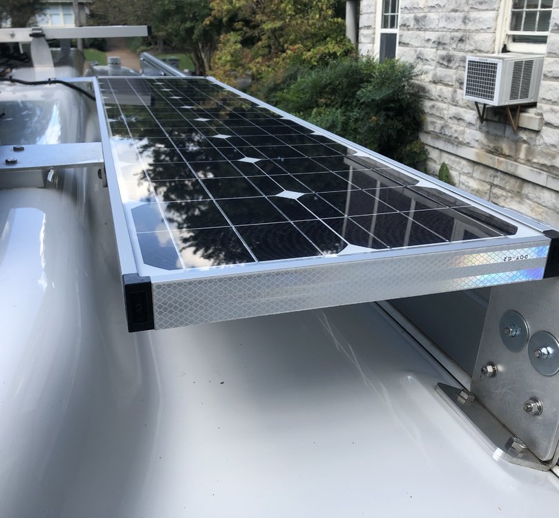

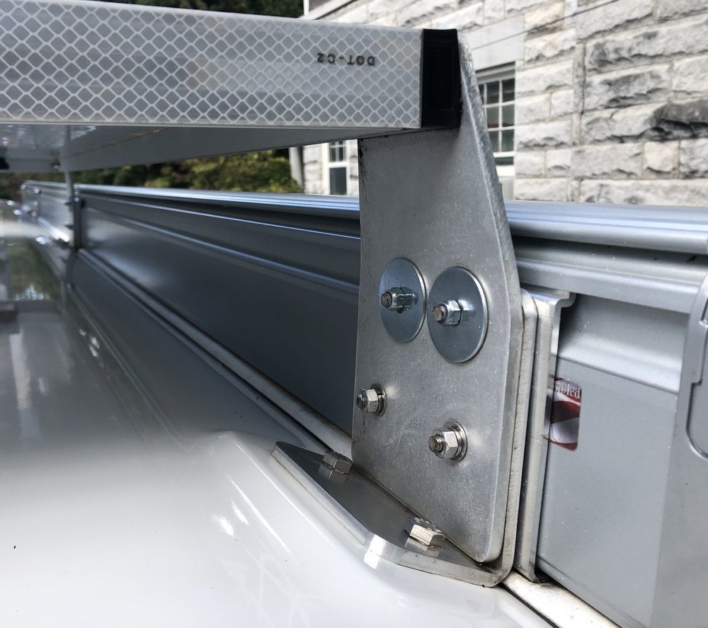

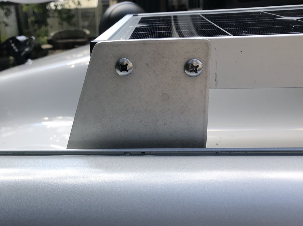

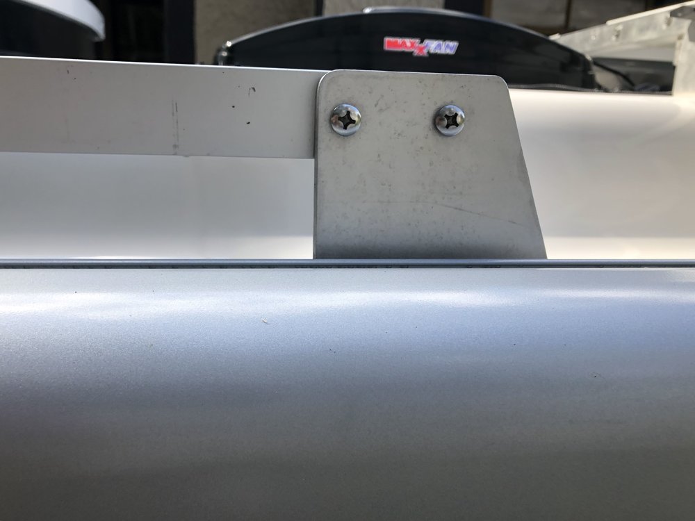

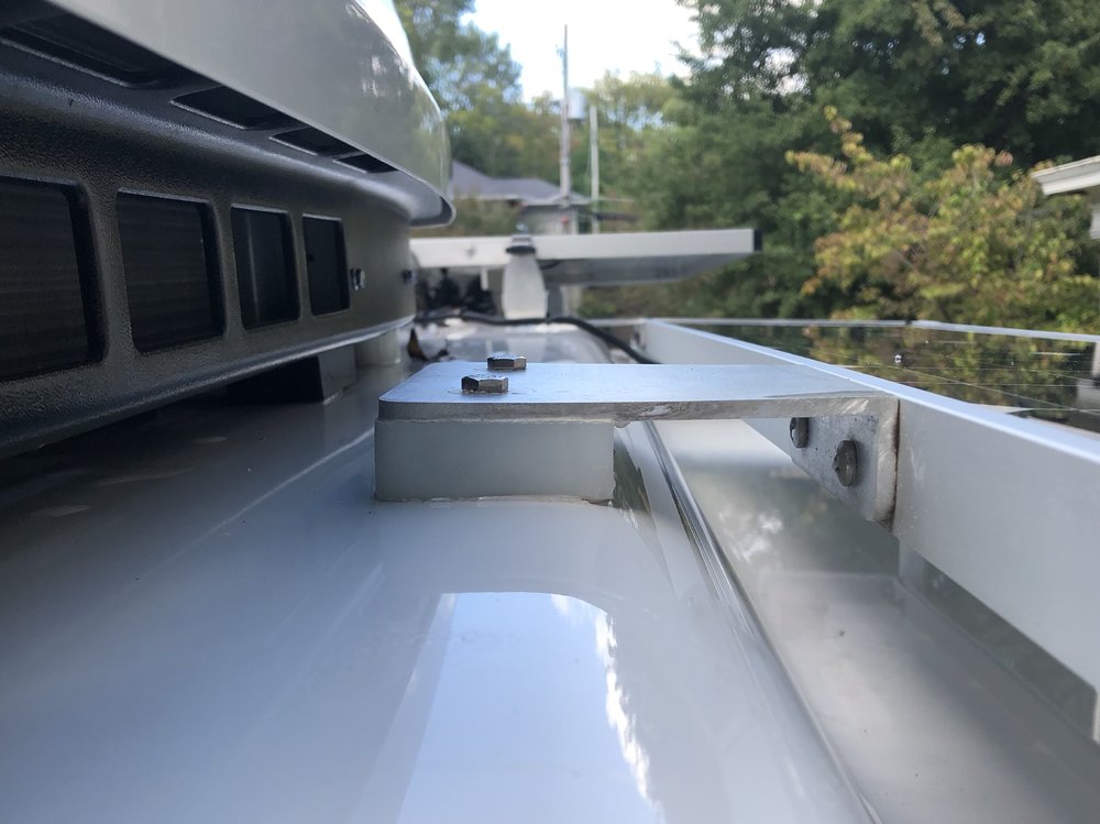

  23. Mike, I have awnings on both sides so they mount the same. Oliver did the mounts for me and I’ll post some photos below. You might call service and see if they’d do the same for you. Not sure about mounting them at an angle since what you gain one side you’d lose on the other so it would probably be a wash at best. Some of the Ollie solar pioneers mounted their larger panels at an angle like you’re talking about so you might search some of the early posts for photos. It would be nice to somehow hinge them or attach them with pins so that they can be removed for cleaning. Though as mine are, I can clean under them though it’s a bit of a bother. The A/C is the only thing to worry about shading the panels but that’s late in the day when you aren’t getting much solar anyway and shading those panels won’t affect the others.
