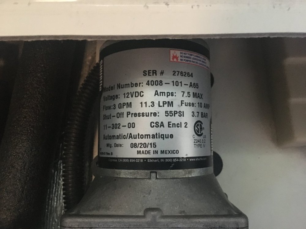

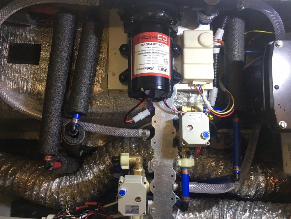

jd1923 Posted March 25, 2024 Posted March 25, 2024 I'm hoping those of you with hull #s >1000 have better water pumps installed by OTT. There are 100s of RV water pump options today! Eight (8) years ago we got this OEM installed pump (pic 1) and with my recent upgrade I installed this instead (pic 2). Retail it's $80 vs $200 and at OEM cost it's likely $40 more which anybody paying $100K larger for a high-end TT should get. Penny-wise and pound-foolish, as they say. 2 Chris & John in Prescott, AZ | 2016 EII #113 | '01 Ram 2500 Cummins!

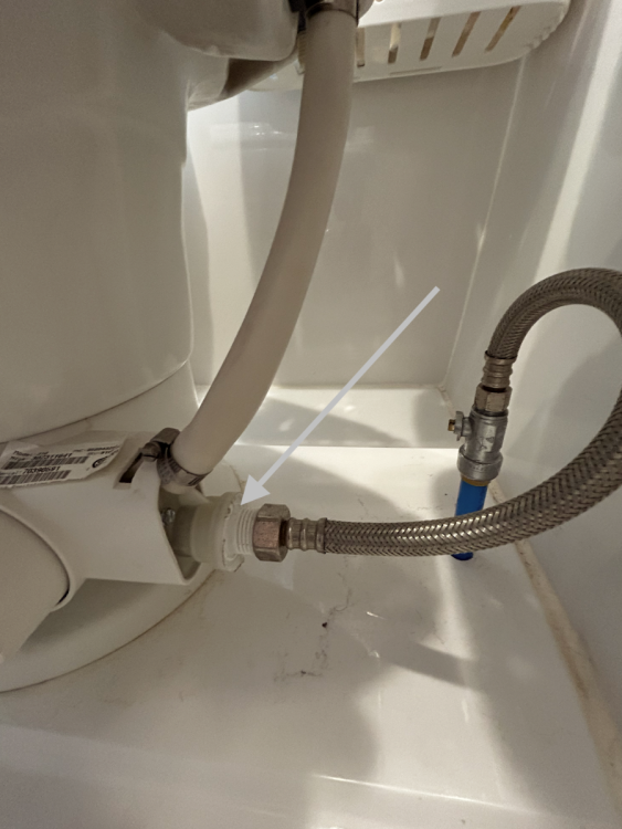

MAX Burner Posted March 25, 2024 Posted March 25, 2024 9 hours ago, Lisa Rae said: I'm not sure what you mean by the diffuser screens? On the rear of our Dometic toilet - where the water connection is, there's an integrated washer/screen at the fitting (where the arrow is pointing below). This screen can get clogged and reduce the flow/pressure to the toilet. The same goes with most faucets. You can remove the screen at the faucet where the water comes out - clear it of debris, and your flow is usually restored. 5 Art, Diane, Magnus & Oscar (double-Aaarrf!) 2022 TUNDRA 2017 LE II; Hull #226 "Casablanca" HAM call-sign: W0ABX

Lisa Rae Posted March 25, 2024 Author Posted March 25, 2024 (edited) @MAX BurnerThank you for the picture, I did not know there was a screen there. Mine has a filter connected to that but I bet there is still a filter there I need to clean. I have done the filter/aerators in the faucets and so far I think what has made the biggest difference is cleaning the pressure regulators followed by replacing the aerator and or shower head. Edited March 26, 2024 by Lisa Rae 1 2016 Oliver Elite II Hull 158 2021 Nissan Titan Home base is FL

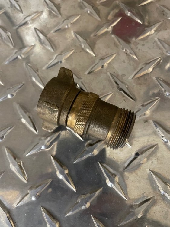

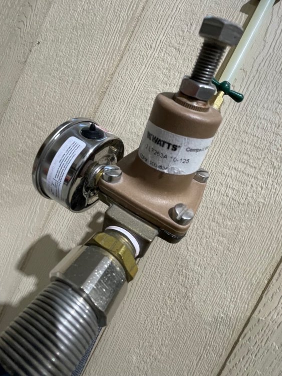

Townesw Posted March 25, 2024 Posted March 25, 2024 (edited) I got better flow everywhere in the Oliver when I switched from this to this https://www.rvwaterfilterstore.com/products/263a-lf-regulator-stainless?_pos=1&_sid=7382cb9a5&_ss=r Edited March 25, 2024 by Townesw 3 1 Bill and Martha 2018 LEII Hull 313 Original owners 3/14/2018 2019 Chevrolet 2500HD Duramax
Lisa Rae Posted March 26, 2024 Author Posted March 26, 2024 @TowneswI am assuming you replaced the internal pressure regulator with a regular tubing/plumbing? 8 hours ago, Townesw said: I got better flow everywhere in the Oliver when I switched from this 2016 Oliver Elite II Hull 158 2021 Nissan Titan Home base is FL
jd1923 Posted March 26, 2024 Posted March 26, 2024 (edited) On 3/25/2024 at 1:45 PM, Townesw said: I got better flow everywhere in the Oliver when I switched from this... to this. Thank you @Lisa Rae and @Townesw! So, when I get a chance to crawl into the rear basement... I will clean the water backflow preventers (aka check valves, a required component to achieve plumbing system pressure, allowing the water pump to cut-off/stop) on both lines and REMOVE the pressure regulators on BOTH lines, and instead use an external pressure regulator. Or perhaps, I could find an alternative to integrate an adjustable pressure regulator internal to the Oliver which of course would be preferred. Love the fact that in the pic, we see pressure regulated to just under 60 PSI, not 40 PSI, anywhere near the OEM regulator. 60 PSI is a good number, 40 PSI is NOT! We run 60 PSI in our 45-year-old home with copper plumbing, sweat solder joints. A modern PEX plumbing system can function up to 100 PSI. Thank about this. Edited March 27, 2024 by SeaDawg Chris & John in Prescott, AZ | 2016 EII #113 | '01 Ram 2500 Cummins!

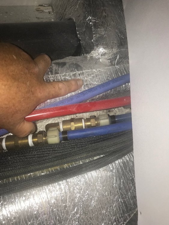

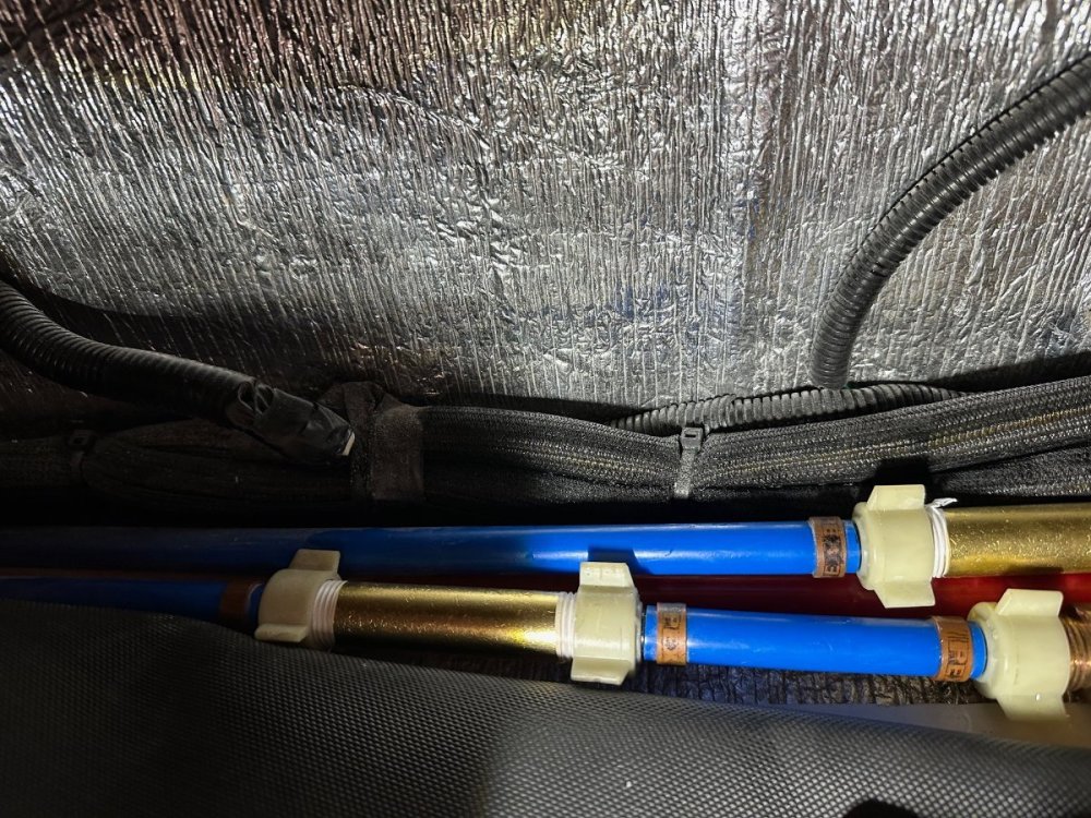

Townesw Posted March 26, 2024 Posted March 26, 2024 (edited) @Lisa Rae @jd1923 I have hull 313. I have 2 check valves under the basement floor just under the door. This is a picture that I made in September 2019 of mine when a few Olivers were having problems with split check valves. I’ve not found any of the brass Camco “pressure regulators” down there. The plumbing diagram shows the check valves but doesn’t show any “pressure regulators”. Oliver provided a brass Camco “pressure regulator” (or flow restrictor) for use externally to limit the incoming water pressure and I used it when our trailer was new. We noticed that when we turned on any water that the flow would be strong and then it would quickly slow. I did some reading on the internet that lead me to replace the “pressure regulator” with a diaphragm type pressure regulator. Video from July 2019, flow with Camco pressure regulator in place at the city water faucet (hose bib). IMG_4032.mov Video from July 2019, Watts diaphragm type pressure regulator in place at the city water faucet (hose bib). IMG_4034.mov I am the kind of person that likes to know how things work and I have thought about cutting the flow restrictor (Camco “pressure regulator”) open to see how it works but, it is my backup in case my Watts regulator fails. (Boy Scout motto: Be Prepared). All of my information and suggestions come with the added warning that what worked in my case may not work for you. Edited March 26, 2024 by Townesw 5 Bill and Martha 2018 LEII Hull 313 Original owners 3/14/2018 2019 Chevrolet 2500HD Duramax

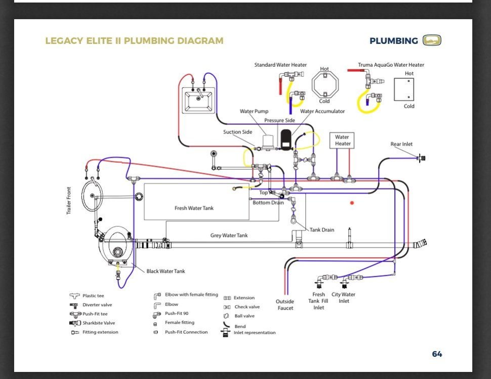

jd1923 Posted March 26, 2024 Posted March 26, 2024 10 hours ago, Townesw said: I have hull 313. I have 2 check valves under the basement floor just under the door... I’ve not found any of the brass Camco flow restrictors down there. The plumbing diagram shows the check valves but doesn’t show any “pressure regulators”... I've seen the schematic showing check valve only before. Yours is that way and easier to reach in your 2018 model. Mine is exactly like @Lisa Rae's and we both have 2016 hulls. Two devices on each line, backflow check-valve AND pressure regulator at the REAR of the basement instead. I found out the 40-50 PSI regulator is a RV standard of old. See this item that Amazon calls "Overall Pick" with 21K reviews: Amazon.com: Camco Camper/RV Water Pressure Regulator | Protects RV Kitchen Small Appliances, Plumbing & Hoses | Reduces RV Water Pressure to Safe and Consistent 40-50 PSI | Drinking Water Safe (40055) : Automotive One of my many summer projects will be to remove the internal 40-50 PSI regulators, clean and replace the backflow/check-valves and get an external adjustable pressure regulator like you showed. Wow, this one is very expensive at $280, but again I don't want the $11 40-50 PSI unit, or one of the dozens of China-made adjustable units on Amazon for $30 +/-. Is yours made in the U.S.A.? 2 Chris & John in Prescott, AZ | 2016 EII #113 | '01 Ram 2500 Cummins!
Townesw Posted March 26, 2024 Posted March 26, 2024 @jd1923 That same regulator package, F3004 from RV Water Filter Store, was $138, shipped, in July 2019. I don’t know where it was made. Google “Camco water pressure regulator vs. diaphragm water pressure regulator” and read some of the discussions that pop up. This is one that I found: https://www.irv2.com/forums/f54/water-pressure-regulators-255560.html We primarily use full hookups, so this isn’t going to help if you’re using the pump. 1 2 Bill and Martha 2018 LEII Hull 313 Original owners 3/14/2018 2019 Chevrolet 2500HD Duramax

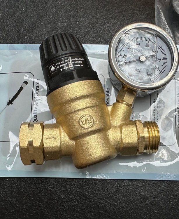

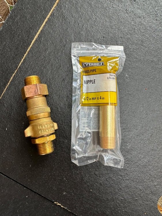

Lisa Rae Posted March 26, 2024 Author Posted March 26, 2024 @jd1923 & @Townesw I think i will remove the two pressure regulators from inside the camper (since OTT did in 2018) in favor of using an adjustable one on the hose going to the camper. I think that will be the best solution because I think a large part of my problem came from those getting clogged up. I'll try and replace them this weekend and test it, along with cleaning the filter/screen on the bottom of the toilet as @MAX Burner suggested. 1 2 2016 Oliver Elite II Hull 158 2021 Nissan Titan Home base is FL
jd1923 Posted March 27, 2024 Posted March 27, 2024 1 hour ago, Townesw said: This is one that I found: https://www.irv2.com/forums/f54/water-pressure-regulators-255560.html Great thread here! This post is key, from senior IRV2 member TeJay: "The cheap RV regulators don't regulate the pressure they just restrict the flow. That will in effect reduce the chance of over pressurizing your system if a CG has high water pressure. You do have a reduction of pressure but also a reduction of flow. With a true regulator you don't lose the flow or volume." Thank you, Bill & Martha! Yes, remove the cheap restrictors and purchase a quality pressure regulator. @Lisa Rae just came to this conclusion as she wrote above. I will also delete the installed restrictors. Lisa, you may consider removing the (winterizing/boondocking) brass water valves that restrict the flow to 1/4". I replaced them with motorized valves, or you could use manual valves that are 1/2" or at least 3/8" ID which is the true ID of 1/2" PEX connectors. Now I see why they only promise the 40-50 PSI range, since they restrict flow and not pressure. This is also the reason why my upgraded water pump provides better flow and pressure pulling from the Fresh Tank, vs when we connect the City Water inlet at the campsite. We still have the bathroom faucet issue, i.e. less flow than the kitchen faucet. There must be something inherent to the plumbing of our 2016 hulls, since many newer model owners do not have this complaint. I don't believe it's mineral buildup, since that would be everywhere, and I measured without the faucet heads installed. You can't "kink" PEX, but more length and multiple restricting connectors could do it. Also in ours, the plumbing in the vanity makes way more noise than our quiet new water pump. After we finish our travel this season, I will open the bathroom vanity and follow the water lines (and the furnace ducting) from the pump at the curbside bed to the wet bath! 3 Chris & John in Prescott, AZ | 2016 EII #113 | '01 Ram 2500 Cummins!
