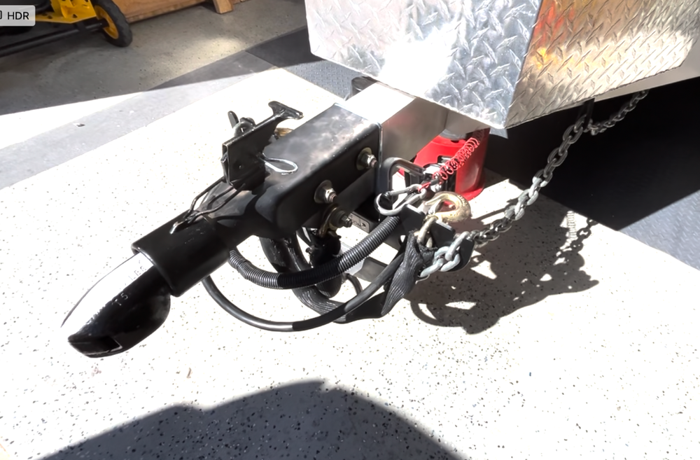

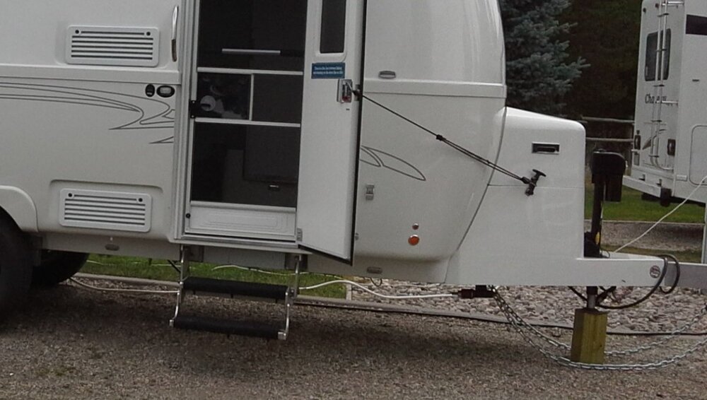

Moderators topgun2 Posted May 27, 2024 Moderators Posted May 27, 2024 (edited) The pic below might not help you too much, but, if you count the number of chain links that Oliver added to the basic Andersen setup you will then know how many to add (assuming that the Andersen you bought simply comes with the standard amount of chain. From there you can then simply use the chains to measure off for the placement of the brackets. Remember, once the brackets are installed, you should normally have between 4 and 7 threads showing after the nut when the chains are properly tightened. Hope this helps! Bill p.s. I've also added a pic showing the placement of the brackets on my Ollie which should help give you a reference point. Edited May 27, 2024 by topgun2 spelling 1 2023 Ford F150 Lariat 3.5EB FX4 Max Towing, Max Payload, 2016 Oliver Elite II - Hull #117 "Twist" Near Asheville, NC
DunnYet Posted May 27, 2024 Author Posted May 27, 2024 (edited) 26 minutes ago, topgun2 said: assuming that the Andersen you bought simply comes with the standard amount of chain Thanks very much - the photo is just what I needed. That combined with the video in Oliver U makes it make sense. I am going to go with that assumption since I could not find a dealer with stock in south Dallas / Fort Worth, and I ended up ordering from the Andersen store on Amazon. I looked through the manual and the install guides and could not find a specification page where they say what the chain spec is. Do you know what the chain size / weight rating is? Edited May 27, 2024 by DunnYet Only pasted part of the post from my text editor - yes I compose post in a word processor to catch spelling errors (LOL) Current: 2023 Oliver Elite II - Hull #1364 "Reset 2.0" (Second Owner) Tow Vehicle: 2023 Ford F-150 XLT 3.5L EcoBoost /w 3.55 axle and Max Tow Package "SIlver" Original: 2022 Oliver Elite I - Hull #1030 "Reset" (Sold) Original Tow Vehicle: 2022 Subaru Ascent "Blue Moose" Home Base: Duncanville, TX

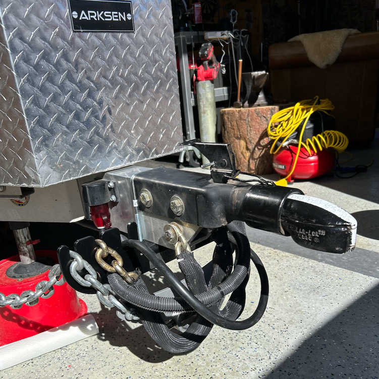

MAX Burner Posted May 29, 2024 Posted May 29, 2024 15 hours ago, Patriot said: It not only looks much nicer, but it does keep the chains cleaner looking. 10’ will work. @DunnYet - FYI: 100% concur with Patriot, @topgun2, and @mossemi -- the thick wire loom keeps the chains squared away and gives a cleaner look, IMO. Torch the ends after cutting to keep them from unraveling and tie-off with plastic wire ties: ...and as @Patriot has noted previously, the Sea Biscuit Designs OTT purpose-built rack keeps the "whale tail", chains, 7-pin, brake-away lanyard, and 12/12v charger cable tucked away cleanly and off the deck. Cheers! 3 Art, Diane, Magnus & Oscar (double-Aaarrf!) (SOLD) 2022 TUNDRA (SOLD) 2017 LE II; Hull #226 "Casablanca" HAM call-sign: W0ABX
Moderators topgun2 Posted May 29, 2024 Moderators Posted May 29, 2024 (edited) Many of us now use this mod but all users should remember to check the condition of those chains beneath the wire loom every so often. Thanks Foy for coming up with the idea. Bill Edited May 29, 2024 by topgun2 added detail 1 2 2023 Ford F150 Lariat 3.5EB FX4 Max Towing, Max Payload, 2016 Oliver Elite II - Hull #117 "Twist" Near Asheville, NC
