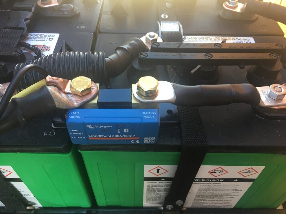

If you have a Victron 712 Smart System installed, you'll have a display (on left) and shunt (on right) that looks like these.  Very high quality gear.
If the solar port wires go:
     A.  DIRECTLY to the Litho's battery terminals, then you'll need to rewire them.
     B.  To the trailer side of your Battery Shunt, then you are golden in two ways.  First, your previous owner was a smart person.  And You don't need to rewire anything.
Regardless when you get your folding suit cases, you'll want rewire them to both mate up to your solar port.

4 hours ago, GlacierGirl said:
We don’t have a Victron  Smart System… and what in the world is a shunt?🤔
I purchased this model, waterproof with sealed wiring: https://a.co/d/aEvZpg2
Wire to battery final ground. Download VictronConnect App to read battery SOC and +/- Amps.
Edited by jd1923
Added app pic
When we purchased a Victron shunt, the waterproof shunt was not available or I did not see it 😐, like the one JD1923 has.
The Bluetooth range is OK while in Ollie and close to where the shunt is located when outside of Ollie, but the range is not good enough to read with smartphone while in the TV with Ollie in tow, at least with our shunt.
You can see rate of discharge and other handy information like SOC on your smartphone, like JD1923 mentioned.
