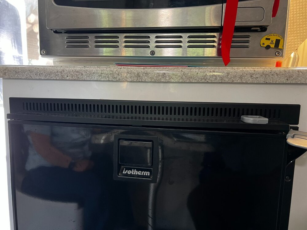

DunnYet Posted July 3 Author Share Posted July 3 5 hours ago, SeaDawg said: Your isotherm vents to the interior of the trailer, not exterior. Is anything blocking interior venting? Any ice buildup in the shoebox freezer? No obstructions in the interior vent - I took out the external vent cover and could see clearly into the interior of the trailer. There is a small amount of frost in the interior freezer, but not so much that we cannot get the ice cube trays in and out. 6 hours ago, SeaDawg said: we've never used a fan in our truckfridge (similar to your isotherm. Same interior, same compressor.) The interior fan is just to circulate the air inside the refrigerator compartment - to keep the temp at a common level. Reduces air stratification where the cold air ends up at the bottom and the warmer air at the top. We did the first couple of days in the driveway without it and the temps where less stable. However, in the interest of science wil pull it out over the next day and see what happens 20 hours ago, jd1923 said: Not being familiar with the Isotherm, does it have a small freezer in the top of the fridge like most models? What if you remove the freezer compartment door? And maybe the door shelf in front of it. The cool would sink to the bottom and the warmth from below would rise and perhaps signal the thermostat to keep the compressor running longer. You would lose a freezer but perhaps get a colder fridge. It might be worth a try, and you could always reinstall the parts later. Yes to small freezer - two ice cube trays is it. The freezer works great, it's just useless for any food. Given the other posts on the forum about breaking off the tabs, I don't want Rebecca to be even more annoyed with me and the trailer fridge by breaking the tabs while removing the door. Will try this in a safe space between trips. 1 hour ago, jd1923 said: I like a fridge that runs on propane and will likely keep ours for a while. The freezer is large (I read the Isotherm freezer is teeny and that it has cycling issues on many online forums). It fits two of our jumbo ice cube trays, large cubes for special drinks, and it cools a new tray down every night. 😂 The tri fuel fridge is the thing we miss most about the LE I Hull #1030. Well, that and the ability to park in two parking spaces in a parking lot. Finding a place to park in downtown Durango today was an experience.... ----- Now - for updates from the road. We traveled from northern NM to north of Durango today, with the ambient dropping into the 70s for the last half of the day. The fridge performed better in the lower ambient temps. While traveling through NM the interior of the trailer (also being monitored with a sensor push sensor mounted above the bathroom door) was pretty much in the low 90's. Once into elevation in Colorado it dropped to the low 80's. Could this just be a design capacity issue? If it's venting into an interior that's already 90 degrees, is that causing a lack of cooling? Also - could I be picking up extra heat being transmitted through the exterior shell into the refrigerator compartment? High winds everywhere we have camped this trip have prevented the use of the awning, so no shade on the curb side of the trailer when stopped. Unfortunately, I don't have an extra sensor push sensor to monitor the compartment temp behind the fridge. Would some type of reflective barrier over the inside of the exterior wall help? 2 Current: 2023 Oliver Elite II - Hull #1364 "Reset 2.0" (Second Owner) Tow Vehicle: 2023 Ford F-150 XLT 3.5L EcoBoost /w 3.55 axle and Max Tow Package "SIlver" Original: 2022 Oliver Elite I - Hull #1030 "Reset" (For Sale) Original Tow Vehicle: 2022 Subaru Ascent "Blue Moose" Home Base: Duncanville, TX Link to comment Share on other sites More sharing options...

DunnYet Posted July 3 Author Share Posted July 3 16 minutes ago, John Dorrer said: Suggest that you add 2 computer fans behind the upper vent screen if you have a LE2 2023 or earlier. Someone will have to assist with how to wire. Great suggestions John - When you are talking vents are you referring to the internal vs external vents? We do have the 2023 with the single upper external vent - however when we got it from the previous owners it had a blocking cover installed in the external vent. It's not an airtight block by any means. Photo of external vent and vent cover. The internal vent is open to the inside -and is unobstructed as shown in the photo from the exterior with the vent cover and blocking cover removed. Inside view. Current: 2023 Oliver Elite II - Hull #1364 "Reset 2.0" (Second Owner) Tow Vehicle: 2023 Ford F-150 XLT 3.5L EcoBoost /w 3.55 axle and Max Tow Package "SIlver" Original: 2022 Oliver Elite I - Hull #1030 "Reset" (For Sale) Original Tow Vehicle: 2022 Subaru Ascent "Blue Moose" Home Base: Duncanville, TX Link to comment Share on other sites More sharing options...
John Dorrer Posted July 3 Share Posted July 3 24 minutes ago, DunnYet said: Great suggestions John - When you are talking vents are you referring to the internal vs external vents? We do have the 2023 with the single upper external vent - however when we got it from the previous owners it had a blocking cover installed in the external vent. It's not an airtight block by any means. Photo of external vent and vent cover. The internal vent is open to the inside -and is unobstructed as shown in the photo from the exterior with the vent cover and blocking cover removed. Inside view. Our upper vent (2022 LE2) had a slot and a mobile RV guy said it should be sealed and he fixed it, and I confirmed with Oliver. The fan would be installed right on the backside of the Oliver cover. Don't have our trailer at home, so I can't check it. If you only have one awning, there is a switch for a street side awning that could be used for the fan (s). 1 John & Susan Dorrer, 2013 F250, 6.2 gasser, 4x4, 2022 Legacy Elite 2, twin beds, Hull #1045, Jolli Olli - Link to comment Share on other sites More sharing options...
DunnYet Posted July 3 Author Share Posted July 3 14 minutes ago, John Dorrer said: Our upper vent (2022 LE2) had a slot and a mobile RV guy said it should be sealed and he fixed it, and I confirmed with Oliver. The fan would be installed right on the backside of the Oliver cover. So ...seal the interior slot above the fridge, remove the blocking cover, and fan force out vent through the exterior vent. Sounds like a do-able project. We have both awnings so will come up with a different switch placement. May just put a switch through the (to be blocked) vents above the fridge, that way we can turn it on when we turn on the fridge and turn it off when doing the shutdown process. Thanks very much!! 2 Current: 2023 Oliver Elite II - Hull #1364 "Reset 2.0" (Second Owner) Tow Vehicle: 2023 Ford F-150 XLT 3.5L EcoBoost /w 3.55 axle and Max Tow Package "SIlver" Original: 2022 Oliver Elite I - Hull #1030 "Reset" (For Sale) Original Tow Vehicle: 2022 Subaru Ascent "Blue Moose" Home Base: Duncanville, TX Link to comment Share on other sites More sharing options...
Moderators SeaDawg Posted July 3 Moderators Share Posted July 3 (edited) In our retrofit install of the tf130, we sealed both vents. (We had both.) We added insulation to the vents, and the sides of the cavity, still leaving an airgap around the fridge. Made sure we had more than 24 square inches of venting, to the interior. No more screening necessary to keep mud daubers out. We've never had an overtemp issue in ours. Normally run the fridge on 5 or so. But, we don't camp in 95 or 100+ degree weather, either. I leave that to younger, more heat tolerant folks. We do keep plenty of cold sink foods/beverages in the fridge. All fridges seem to work better when loaded, vs empty/lightly loaded. As someone else suggested, all the cold comes from the tiny freezer. I think the temp sensor is within the wall of the freezer, as well. There are some air slots at the back. Maybe move your fan from center to left, and try to draw more cool air from the freezer? You could also have a faulty thermostat. Isotherm sells a kit which includes a sensor in the fridge cavity, as well. Many boater use it. I think Overland installed it for his, maybe. I'll see what I find. The other suggestions of shading the fridge side are good. Wondering if you have a true 24 square inches of interior venting? Edited July 3 by SeaDawg 1 3 2008 Ram 1500 4 × 4 2008 Oliver Elite, Hull #12 Florida and Western North Carolina, or wherever the truck goes.... 400 watts solar. DC compressor fridge. No inverter. 2 x 105 ah agm batteries . Life is good. Link to comment Share on other sites More sharing options...

rich.dev Posted July 7 Share Posted July 7 (edited) I believe there might be a ventilation flaw with the 2023+ Olivers with Isotherm fridge, at least mine. There is no vent at the bottom so cold air can enter at the bottom, pass behind the fridge and warm air can leave at the top. Per the installation instructions, see “ventilation” in last pic. I have emailed Oliver, will post the response. Vent at top of my fridge No vent at bottom of my fridge Installation instructions Edited July 7 by rich.dev 2 2023 Elite II, Hull# 1386, Lithium Platinum Package (640AH, 400W Solar, 3000W Xantrex Inverter) Truma water heater & AC TV: 2024 Silverado 2500HD 6.6L 10-Speed Allison Link to comment Share on other sites More sharing options...
